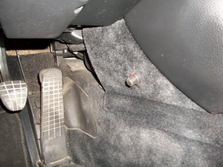

I have a 2000 986 that i bought used about a month ago from a broker that didn't know much about the vehicle. I found what appears to be an aftermarket dual rotary switch on the side wall near the accelerator. The outer dial is a two position on/off switch and the inner dial is like a volume dial (see photo - A). When I turned it - on the lights on the B (red) /C (green) blink and light up. There is also an audible beeping noise that sounds like a radar detector. After a few seconds the red lights go out and the green light remains illuminated - and the beep continues every few seconds. I soon loose my nerve and power it off - fearing it is a 007 ejection seat or something.
So I'm thinking a radar detector?? Nothing else seems to be different about the car when its on. Any ideas???

The controls sound like a radar detector - on/off button + sensitiviity control + status lights + beeps.
If its a radar detector, you should be able to find the receiver in/under/around the front bumper somewhere. Take a really close look and see what you find.
Alternatively, follow the wires from the footwell switch up under the center console and try to figure out where they go...

It's a switch for a K-40 stealth radar detector.
Depending upon the series, this can be a good thing... or next to useless.
Either 2 LEDs have been added to the dash (as in your case), or 2 factory warning lights are comandeered for the indicators.
The switch is ON/Off/Sensitivity and the outer is volume control.
You will have the control unit mounted either under the dash or in the frunk and also will have the actual sensors located behind the bumper covers.
go to k40dotcom for more info.

That is a K40 Undetectable Radar Detector.. The 2 Led's are for front and rear detection. The knob on the side does.. ON/OFF, CITY/HIGHWAY, And Volume..
If the system chirps once every 2 to 3 seconds.. You've got a problem with the front sensor.. If it Chips twices every 2 to 3 seconds.. You've got a problem with the rear sensor..
Could possibly just be the sensor is unpluged or you got a loose wire somewhere.. Replacement sensors retail for around $400.. and K40 is located in the burbs of Chicago near Elgin.
I used to be an installer and I've got the same system in my 99.. Let me know if you need some other help or a wiring diagram..
