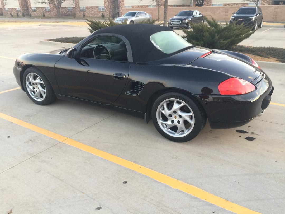

Looking to get some spacers for my friend's 1999 Base Boxster with 17" Turbo Twist. I'm thinking 15mm on the rear and something smaller on the front like i have on mine but let me know what you have.
Ideally they would come with the right size bolts but can also get those separately.

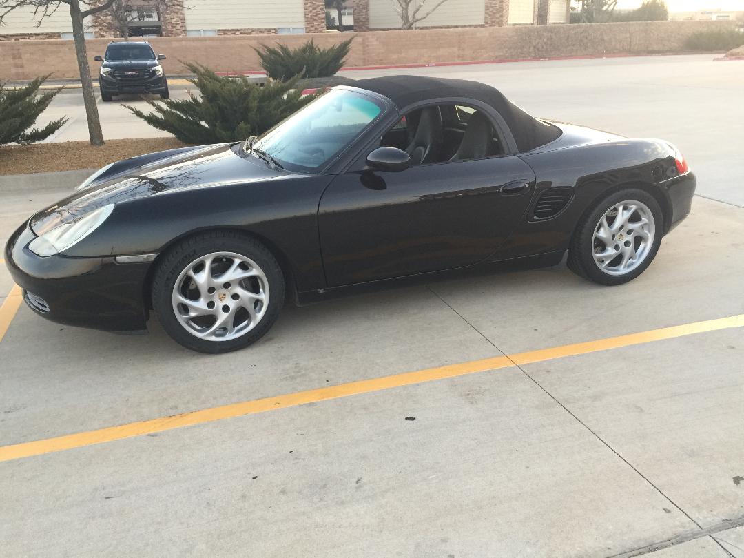

I just this past week installed a set of Dyno wheels refinished (they are the same size/offset as Turbo Twists) with new tires 205/50/17 front and 255/40/17 rear.
I went with 15mm spacers and new lug bolts front and rear. Absolutely no issues with extending past the fender well. No rubbing or any fitment issues. After installing 15mm on all 4 corners, I'm going back to put 20mm on the rear. There's plenty of room.
I think you'll like the wider look. It fills the fenders out much better and still retains a stock look.
The pics aren't good. I just pulled the car out of the tire bay and it's not settled from being on the lift, but hopefully you can get the idea/

looking pretty sharp! i like how 15mm looks on the front!
