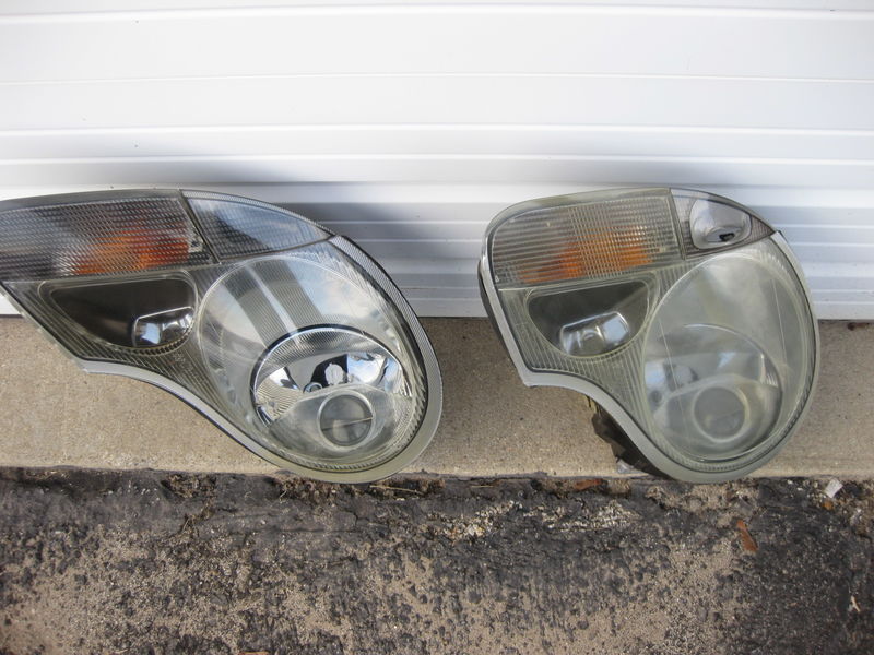

Photos, if you, or someone else, is interested
Passenger side (right side for those on the other side of the pond) used Porsche factory litronic headlights for sale. Below are two examples. One, appears to have had the lens cleared and re-coated. The other could use that service. The one that is more clear has a broken plastic tab that holds the ballast, so it is now held with a screw. The rubber seal surrounding the other headlight has deteriorated. Both work, both have bulbs.
$375 each payment via PayPal
Shipping to your confirmed address via UPS ground.
Sorry the picture is updside down, but you get the idea
Shows screw holding back on
Shows rotted rubber

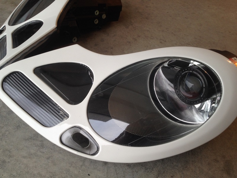

Originally Posted by ryanjboutin View Post
Side note: I was texting Woody yesterday, he mentioned you may have done a retrofit in these headlights.
Yes, I did. There is no way to mount aftermarket projectors into Lits, so I mounted the projectors into standard halogen reflectors, then swapped the entire assembly into the Litronic headlights, replacing the Lit reflector/projector assembly.
They were for a 996 Carrera and were the best of both worlds: The higher output of true bi-xenons coupled with the self-leveling of Lits.
