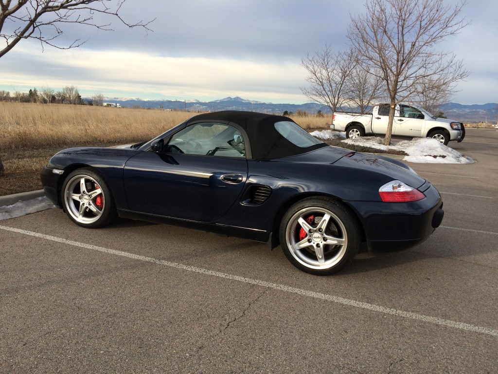

I have a 2001 that I bought 2 years ago. Great car, great color, I love it! It came with a clear bra installed. Here is a picture from yesterday.

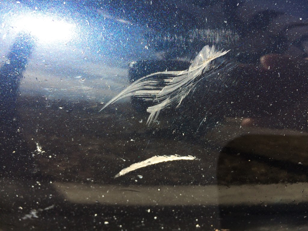

While washing it this weekend, I found this damage to the clear bra on the front bumper.

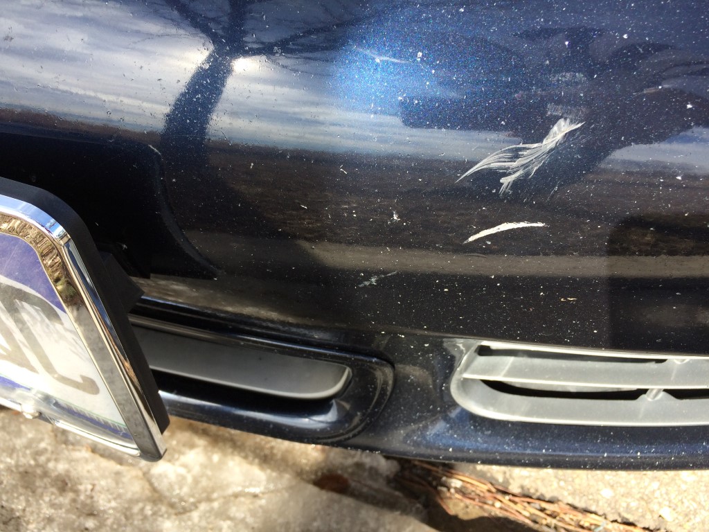

Close up. Notice the million or so little rock chips as well.
As you can see, it is pretty big and I would like to know if
1) Can it be fixed?
2) Can the clear bra be removed?
Thanks in advance, John

You may be able to use conventional paint polish & wax to correct the damage to the bra. That's worked for me before.
I pulled a clear bra off a 968 earlier this year that had been on for 10+ years. Acetone, heat gun, plastic razor blades and lots of patience were all necessary. When the bra came off, the paint underneath had been protected so well that it had not faded... unlike the rest of the car. Hard to see here, but there was a distinct "horizon" about 4 inches up the hood.

You can actually take a clay bar to the clear bra and you may be able to get the scuff out of the bra

Try some of the same stuff that's used to correct faded headlights. I just used a 3M kit (bought at the local auto store for $15 and it includes the bit, various grits of sandpaper and polish) on my daughter's Mini and it worked wonders. They look like new again. The clear bra isn't too different. The only tool you need is a drill and some time.

Thank you for these suggestions. The detailing guy told me he would probably use a wool pad on his polisher. Not sure what polish he would use.
I will try this weekend and post results!

Xpel is nice stuff and it can heal itself with a little heat from heatgun or hair dryer. To OP have you tried heating up the spot with a hairdryer ?
