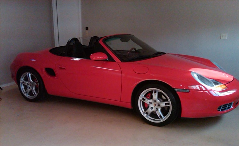

Got my new rims and tires yesterday, got them mounted late today. Went from 17s to 18s. Tires being new are a little squirmy but the turn ins are so much sooner, just love it.
Bought the rims Friday from Kurt and they were delivered Tuesday night...as they would say on ebay, "great seller!" Thanks Kurt.
Picture is a little fuzzy, it was getting dark when I took it, I'll get better ones later.

It looks really high up for some reason. Are the tires the same rolling diameter?

I think it was the early evening light that made the dark between the tires and fenders appear bigger...also I had not let the 46lb of air out that was left in there by the garage. The tires are sized right for the rims, 225/40/18 and 265/35/18. I'll post a pic with better lighting.
Taking a second look I see what you are saying, especially in the front...my eyes were going to the rear where it looks ok...but they are correct size.

Something is up. Your front is sitting way too high. This is my car back in 08 prior to me having the RoW M030 supsension installed. Even then, my car with the same wheel dimensions sits lower than yours.
Need to take it back to whomever installed and check the springs or something.
See attached.

I'm sure it is just a weird pic, it was almost dark and I hadn't let the 46 pounds out yet. I measured the diameter of both the old and new tires/rims and it is exactly the same.
Blue, give me a measurement from underside front of the car to ground and from your driver door underside to the ground...you guys have me thinkin crazy
Oh wait, I'm on a side hill! Duh! Give me the measurements anyway if you have the time.

Phew, try again, this time flat surface. I measured to lowest point also, is 4.1 inch per owners manual. Phone camera bites, I need something that takes nice clear pics like Wade's.

Still looks about 3/4" high to me. Compare the centre of the front wheels to the line along the sill. Even in your newer pic (which does look better) the centre of the crest seems to be lower down (when aligning with that line below the door) than the others? Could be just an eye trick.

Could be the new Bilstein HD front and Sport rear that maybe have a little more push upward. They work great though . Took if for a spin tonight, perfect weather here in Charlotte if you don't mind pollen.

It still looks a little tall to me too.
The RoW M030 shortens the front springs by 20mm, rears by 10mm. I'm on this suspension so my measurements wouldn't help you much.

Glad you're happy, and I don't think it looks higher, except that first shot taken from ground level. My low angle shot of my 987 makes it look like it sits higher than it does, also.

The car did look funny in that first pic, I had jacked it up on a side hill so it was riding a little high. It is possible on flat that it is a little high in the front, could be the Bilstein HDs...need someone from a non-RoW 986 to send me some measurements so I can check. If it is it just a small amount, no big deal to me, handles great and looks sweet.

Those wheels look sweet on your car. I love silver instead of chrome. good choice and good upgrade. I dont think there is nothing wrong with your springs or suspension. When i jumped from 17" to 18" I also noticed a slight increase in height. I do believe that my ride gained about 1/2 more in height due to bigger rim and taller tire. I did compared stock 17" and 18" unmounted tires/rims and again, It was about half an inch difference. After the fact, I installed Eibach springs and even though they claim they are compressed and ready to use, I also noticed differences in height in almost all wheels. Took several weeks for the new suspension to settle properly. I still notice sometimes slight differences but mostly due to uneven ground. Give it a couple of weeks before tearing it apart to see if that solves the problem.
