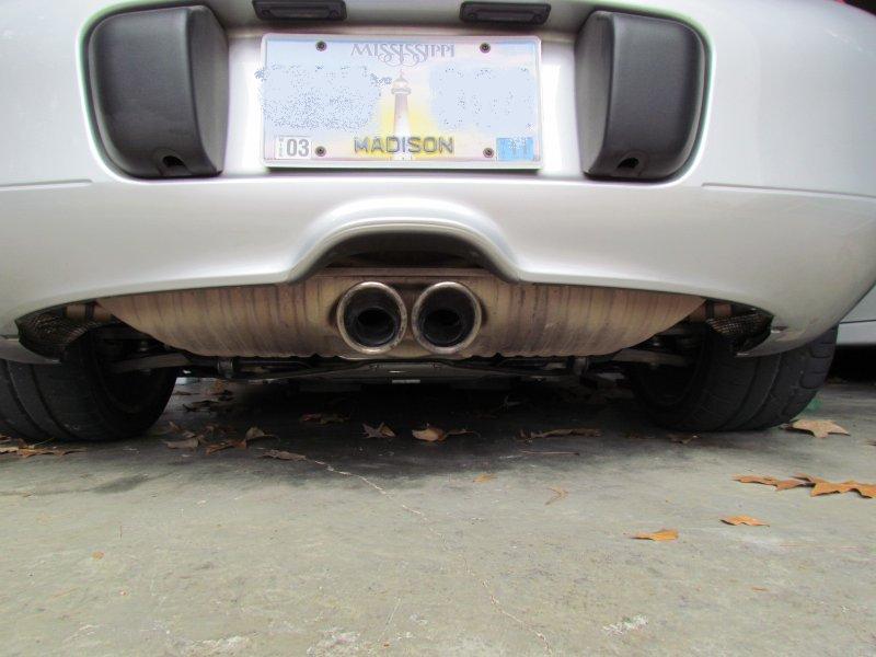

I decided to clean up the muffler a bit.
Before:
After:

Looks good! What did you use on the pipes?

On the muffler and the tail pipes I used the same process.
Sanding with 320, 800, and 1000 grit sandpaper.
Followed by buffing using a rotary buffer with a wool pad and buffing compound.
