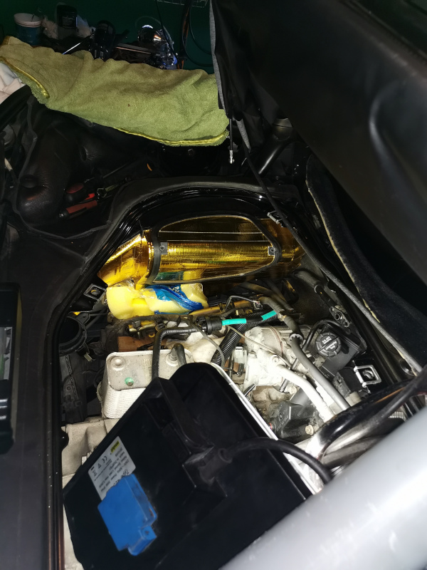

I cannot believe what I'm seing but there it is..
I managed to squeeze in the 987 box, I struggle to get the bolts in to fasten the box. Then I realize that there is no way, as you can see in the picture the end of the tube hits the "roof" of the engine bay but the bolt hole is still far to low.
What is going on here, would really love your thoughts, I don't get it.. The airbox is from a 987.1, the car is a 986s 2003.
It's supposed to work, right?

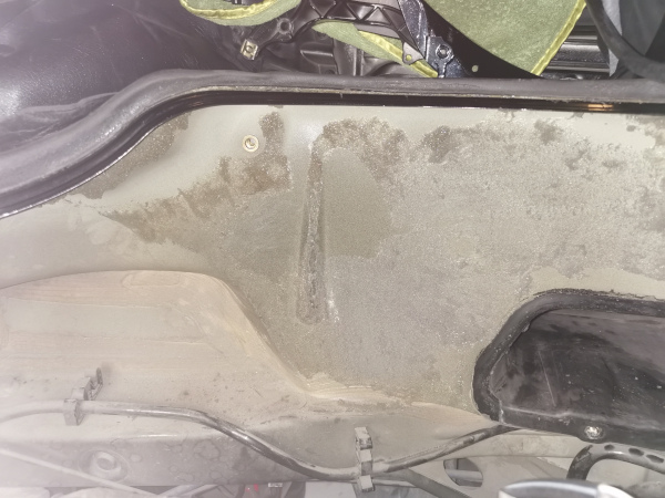

After a nights sleep I went to it again, itīs getting closer..
The box is in, it just wont line up with the bolts without the pipe to the MAF hitting the wall.
What I did to get it in was the classic steps, removed intake and fuelrail, since I also will be swithcing out the front engine mount I removed this and lowered the engine enough for the box to slip in.
Since yesterday I have taken the box out again and trimmed away all the insulation behind the box, this made a big improvement. Now I managed to get in the front bolt, but the other two still feels really tricky.
And the MAF, will it really fit without cutting some of the plastic.. Something doesnīt feel right.

So.. Found a hose clamp that was hindering the box to settle properly, so now.. Finally the box is bolted in.. This was worse than expected.
