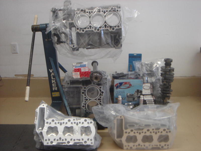

I have a 2001 3.2 with LN 3.6 cylinders & JE pistons & lightly ported heads It will run just as good as the 3.6 in my car without touching the DME. Its for sale in the classified column.
Thanks for the offer, you are asking a very reasonable price. However, I’m leaning toward a 3.8 and have already started buying parts to build the engine myself. I enjoy engine work and am looking forward to the task as well.
