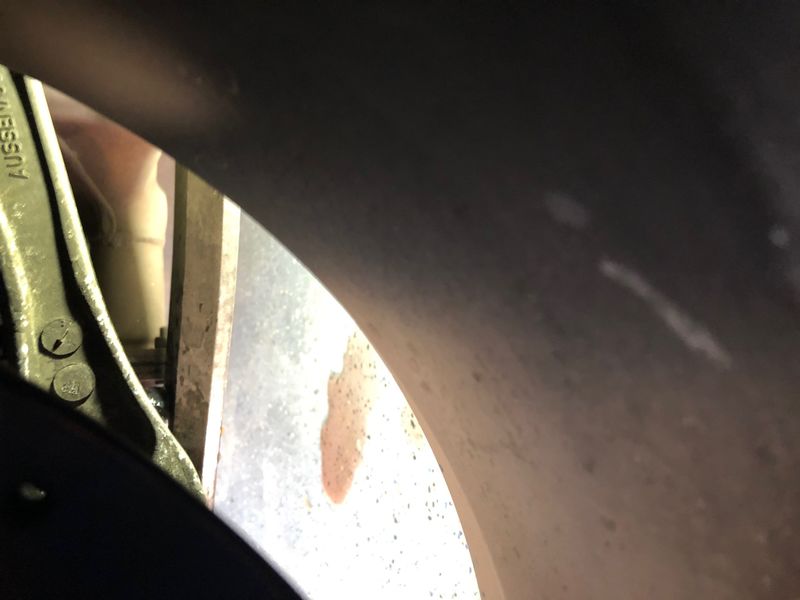

Posts: 345
View from in front of passenger rear wheel
View from through passenger rear wheel

In the second picture I see a wet bolt. I'd check the plastic hose connector from the oil/water exchanger to the expansion tank. It is almost directly above that area. They have failed before.

I agree with 911monty. The good news here is that it's not wet EVERYWHERE, which is frequently the case with a leak on the bottom.
Take your flashlight and follow the trail up. I think you're likely to find a slipped hose clamp, or some such.

New overflow tank required. Just got it back from my indy mechanic.
