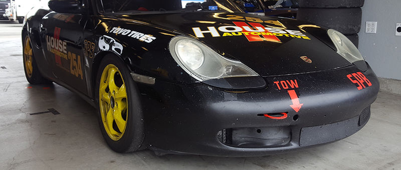

Here's one of mine on M030 (slightly lowered suspension) with stock 17s in a 'mirrored' perspective. See the difference in back? that's more than I'd expect from just cut springs.

...I think the stock 17" wheels are 7" wide in front with the rears 8.5".
This is the correct size wheels.
Fit the proper springs and correct rear wheels/tires and then see how it handles. Should be about 1000% better.
