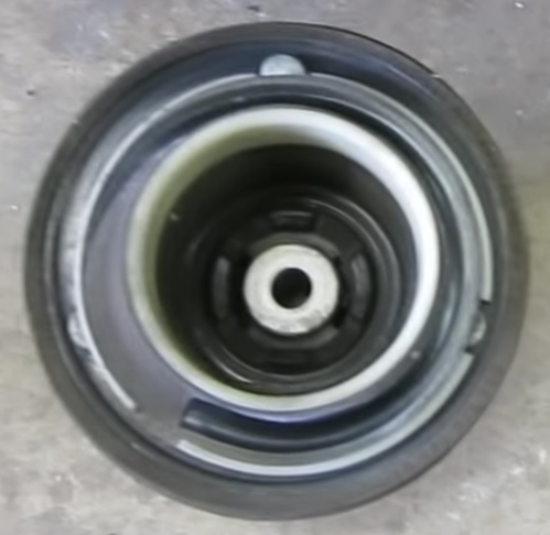

I'm getting ready to put my Koni FSD struts and shocks onto my 03 Boxster S. I am using springs that will lower the car 1" at all corners. The one thing I'm not sure about is the Compensating Plate size I need to use.
In this picture of the front struts part #5 it shows two different sizes. It shows 3,0 Mm and 6,5 Mm and I have no clue which size I need. Also the chart has an X out to the side, so is this an optional piece?
In this picture of the rear shock part #3 it shows two different sizes. It shows 3,0 Mm and 6,0 mm and I have no clue which size I need. Also the chart has an X out to the side, so is this an optional piece?

Just watched a video of the shock being taken apart and put back together and the Compensating Plate is needed as it is what the spring sets into. I'm going to go with the 3,0 Mm size unless someone says different.

I don't know why that site calls them compensation plates. They are rubber and the springs sets into them.
Front
Rear
Most people reuse them, but I want new parts as my car has 127k miles on it.

That's good to know. Thing is I'm also changing the springs, so I'm not sure how the new springs would fit into the groves created by the old springs, plus the cost for new ones is only $26.16 for all four corners. I also decided to go with the thicker pieces.
I suppose this would be why it takes time for the ride height to settle in as the springs will be making new groves in the rubber.

I took the back wheel off and looked at the piece, on my car it's definitely the 6,0 mm piece. After looking at a picture of the front 3,0 Mm size piece, I felt it was too thin and decided to go with the ticker one.
This is the 3,0 Mm compared to the 6,5 Mm for the front.
