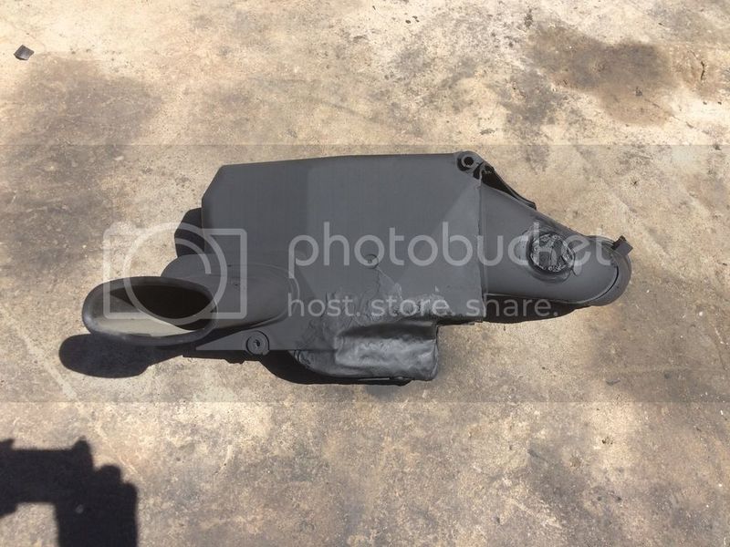

Posts: 2,644
This is how much I had to trim to get it to fit
Thanks, I think I have done the proper cutting, cannot take a picture right now since it is in the car at the moment.. Try to illustrate with your pic:
