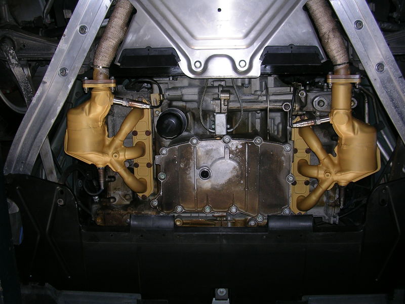

I am only about a month away now from wrapping up a top-to-bottom review and rework of my exhaust system. I'll end up with what I personally feel to be the "right" system for me and my usage of the car.
My intent is to start a new "What I Did" thread here once completed. But here's a sneak preview picture.
Thanks - DM
http://986forum.com/forums/uploads02...1529680880.jpg
Looks good the Danks sport converters are nice.
