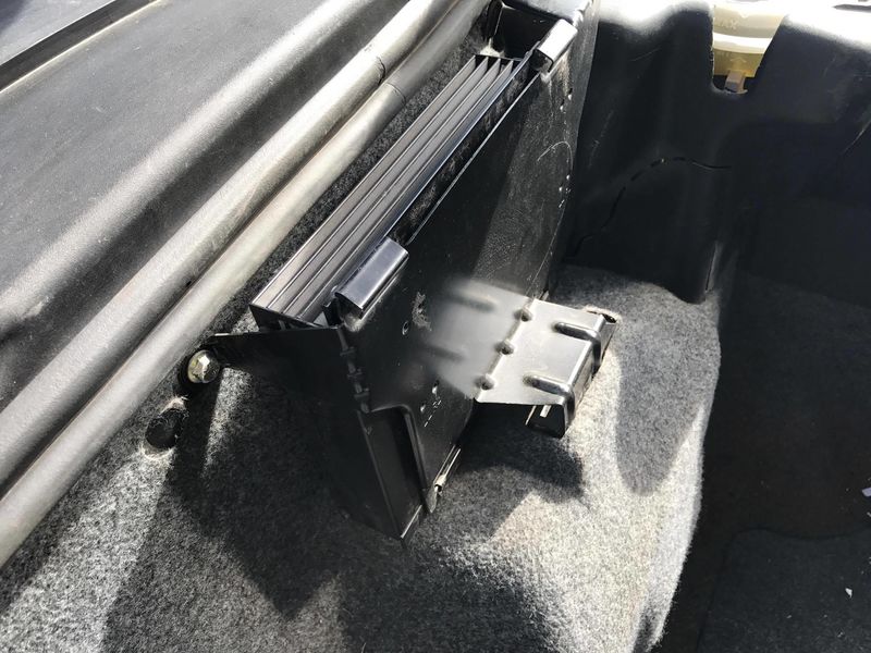

Im currently changing all speakers in my Boxster '99. The orginal 4x40w amp in the hood isn't delivering enough power to my new Alpine Type-X speakers.
So I bought a 4x400w amp, and Im going to replace the original if I can.
Is it completely safe for me to change it out for another amp?
Photo of the speaker amplifier below.

Maybe its unclear what I'm asking about I can change out the orginal amp without any problems? (Its not connected to any computer thingamajig?)

Yes it should be fine. I would run a proper size power and ground cable for the new amp. You should be able to use the existing speaker wires that run from the amp. This is assuming that this car doesn't use the MOST fiber optic system. I'm pretty sure a 99 uses a regular system.

yea its all analog.
I say this with ultimate respect, but if you are at asking these sort of questions, my advice to you is to let someone in the field of car audio installation do this for you.
Tommy has a point, not sure about the 400X4 but I have a 'bench-test' 200x4 here and it needs a 8 gauge wire and a 20ampX2 circuit to run. Not the type of circuit you find in every Porsche these days. It is HOT as f... also, I actually hate it lollll

You can use any amp you'd like on a '99. Nothing scary or optical. Go for it!

Did you use Alpine components? Where did you mount your crossovers?
There aren't many amps that will fit where the stock amp is. What model amp did you purchase?
You'll have no issues wiring directly to the factory wiring - the signal (rca) wiring was a bit tricky in my 02 with Bose, if I recall.
In my car, I used the OEM amp housing to mount a signal processor, and I used the OEM plug to interface to the car's wiring.
