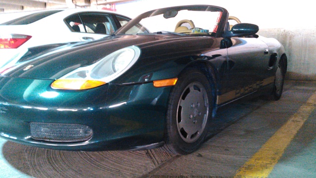

I've poked around, but as far as I can tell nobody else has done these wheels on a Boxster. I'm trying to get a retro kind of look, and I've settled on 16" 928 manholes. I have them on the car and I like the look. I'm getting some rubbing up front in tight turning, but otherwise no clearance issues. I'd like to push them out, though:

Maybe it's because of the green car, but I like the 928 look on this car. Really needs those spacers though!

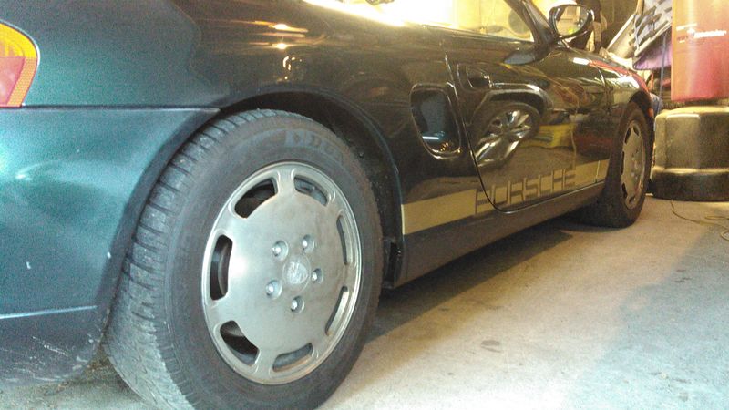

Got them a couple days ago and they went on easily. No more rubbing in the wheel wells and they look a lot better!

Shaun your car looks nice with the spacers and the 928 wheels :-)

If you wanted retro, the look of the rear wheels in your first (pre-spacer) pic has a very 356 vibe.

Im getting panamerica concept vibes.
I thought so as well, but I prefer to the look with the spaces, and everything does fit and move better.
