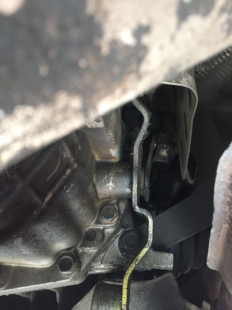

New here, with a new to me Boxster S with 153000 miles. This car has a leak where the clutch linkage enters the trans. Questions for the experts here:
-- Does the trans need to come out to fix this?
-- Will I have to open up the trans to fix this, or can I repair it from outside?
I searched and found some info, and so far I've read that you have to open the transmission, and one post said you have to machine it for a new bushing. Is that right? Or would an OEM bushing last another 150,000 miles? Thanks for any input. Going to try to attach a photo. It's leaking where the linkage enters the trans, which is right about the middle of the photo.

This is likely the most common issue with the 6 speed trans, likely more common than the second gear pop out or second gear grinding. Unless you are losing so much fluid that it pools in your drive way it is not a big problem. The bushing is fixable but cost is high and takes removing the trans.
Mine has this issue but is more like a 'weep' than a 'leak'. It has done its since I bought it 4 years ago and has not gotten any worse.

Thanks for the info, Paul. I may very well live with it if I can overcome my urge to remove the transmission. Can you confirm that I must disassemble the transmission to replace the bushing? That may be the difference for me.

Everything I have been told or read indicates trans removal and disassembly to repair the bushing leak. A member of the board here, Timco, posted this so you may want to follow up with him.
http://986forum.com/forums/general-discussions/59008-anyone-familiar-manual-transmission-leaks.html
