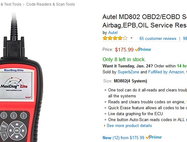

Can the air bag code be reset by using the less expensive Durametric Enthusiast model, or does it require the more expensive Durametric Pro?

Enthusiast model should be able to do it. I have the even less expensive Autel MD802 and have reset airbag lights in one of my '99s and the '01. It also does well on my Audi, my wife's Honda, my son's VW, and even a friends Dodge Ram truck.

While my accidentally having triggered the air bag light is an annoyance, the experience has now offered me enough of an excuse to justify going out and buying a code reader / resetter, which I have been wanting to do ever since I bought the car.
