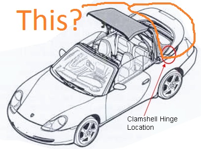

Is the "latch" that you are referring to what is also called the "clamshell"

Hi
Yes, clamshell was the part i meant
