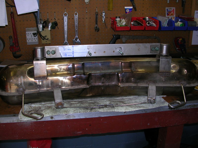

I am ready to hang my new (used) Dansk sausage muffler, and I have noticed that the horizontal hanging bracket has offset holes for the main support bolts. I did not catch this subtle difference during disassembly, and so I now have a 50/50 chance of putting it wrong side up since this horizontal bracket can be fitted either way round.

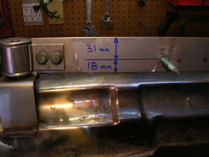

See enclosed pictures of the backside of the muffler, where I have noted that the dimension from the edge to the bolt centerline is about 31 mm down and about 18 mm up from the bottom, as I have it installed at the moment.
Is this the right way up?
Or, do I have it bass ackwards, and the 18 mm distance goes towards the top, while the 31 mm is down towards the bottom edge?
This muffler is heavy, and I do not fancy the idea of having to uninstall it after discovering too late that I have it the wrong way up!
With many thanks - DM

It looks like you have it right. See pics below...there seems to be more space above the center bolts than under it.

You have it in the correct position.

Thank you Boxtaboy and JFP for the confirmation - it was just down to dumb luck that I attached it as I did, not noticing the spacing difference until after the fact.
But I do now admit that I find it quite odd that this part does not come with any sort of a "This Side Up" marking, as it is obviously super easy to flip it around the wrong way.

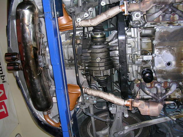

Since this issue has come up, here's a couple of work-in-progress pictures of one of my pair of gutted secondary cats. I cut the end of the canister off with a band saw, removed the heavy (7 pounds each!) metal honeycomb core, and then rewelded the end cap back on it.
End result should be a nice stealth look (disclaimer: for off-road use only of course).
Thanks - DM
Thanks - DM
Maybe some people did exactly that (install the other way), and thus it looks like their exhaust tips are touching the bumper cover. And wow!!....the canister looks like a major restriction!
