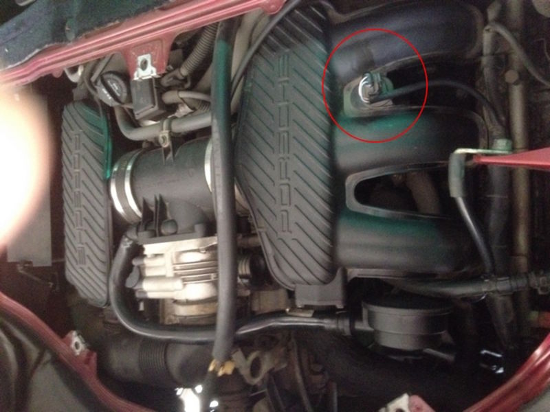

Old 07-08-2016, 02:12 PM   #6
911monty's Avatar
Posts: 1,476
I've got 2 from when I upgraded to the S cooler.
The hose routes around and below the TB.
I believe the hose with the green printing is the vent hose as it passes below the oil fill tube.
Old 07-08-2016, 02:42 PM   #7
madmodz's Avatar
Join Date: Jul 2012
Location: Scottsdale, AZ
Posts: 174
Whats this line?
madmodz is offline   Reply With Quote
Old 07-08-2016, 02:52 PM   #8
911monty's Avatar
Posts: 1,476
Man I sure screwed the cropping on that image. Without going out and opening the engine up, someone correct me if I'm wrong, I think that is the ground cable going to the block.
Old 07-08-2016, 03:33 PM   #9
911monty's Avatar
Posts: 1,476
Yep. Found this image that shows the end. It is the engine to body ground strap. Not the circled temp sensor. Yes I plagiarized....
