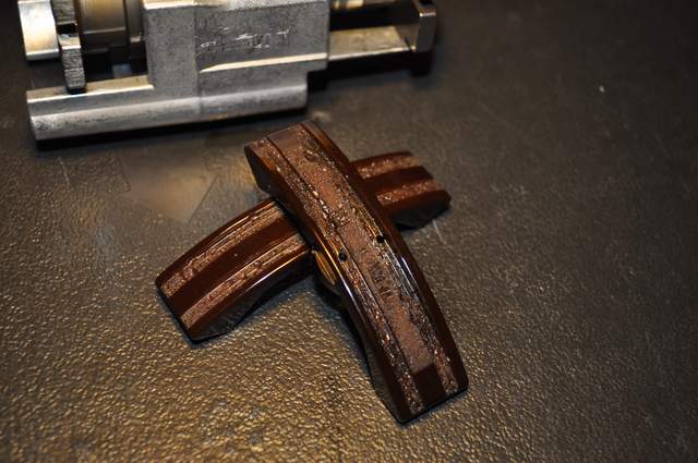

Installed new LNE/IMSB today, although the old double row after almost 50000 miles was still perfect - no play whatsoever. Along with that replaced the RMS, pilot bearing and clutch...
and due to the fact that the cam deviation was off a little I pulled the cam covers and replaced the vario cam pads, cam to cam chains as well as a set of new tensioners :-)
should be good for another 14 years now
You can clearly see the lower was actually wearing where the chain center is... glad I replaced them.

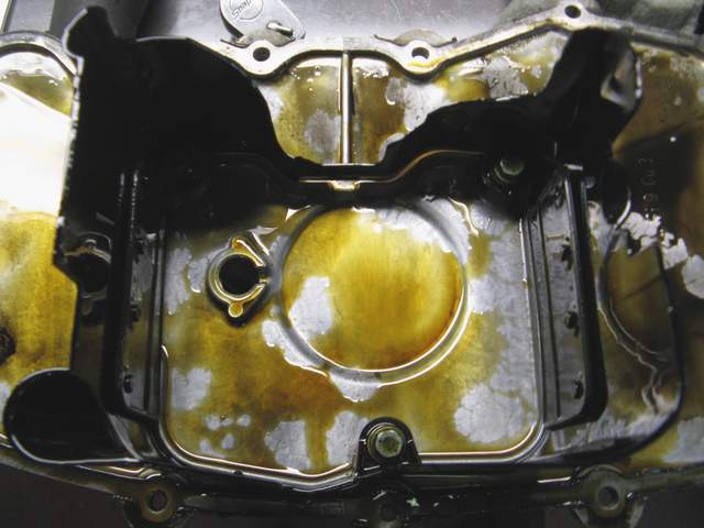

Sump plate, after pulling it

Had you been noticing pieces of plastic, from your vario cam pads, in your previous oil changes?
Old 05-07-2014, 11:18 AM   #5
Heiko's Avatar
Join Date: Sep 2012
Location: Guelph, ON
Posts: 981
Just a few pieces here and there, nothing out of the ordinary... I've taken others apart and they were filled with plastic bits. Sometimes they tend to collect between the sump plate baffle and the little raised ridge on the inside on the plate but nothing to be found there either...
