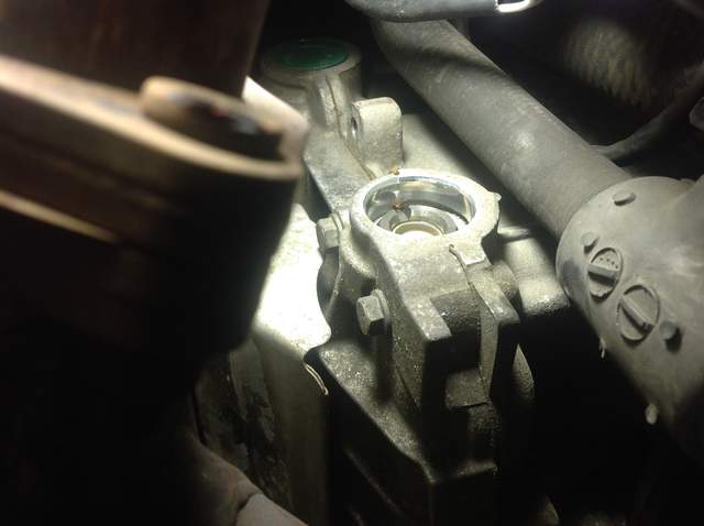

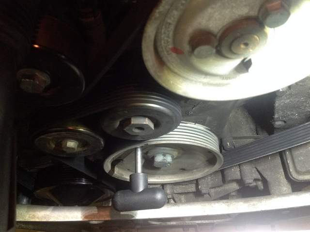

I was very careful on valve timing and used the lock down tools with the engine locked at TDC.
