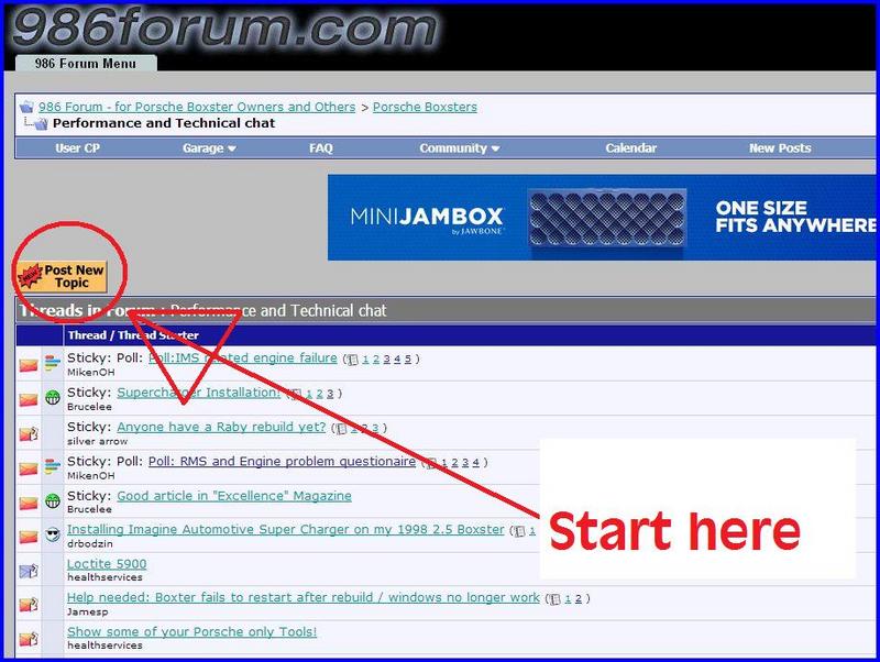

How do I post a new question?
Asmiley is offline   Reply With Quote
Old 01-17-2014, 08:38 AM   #9
Registered Boxster abuser
healthservices's Avatar
Join Date: Oct 2011
Location: socal
Posts: 1,014
