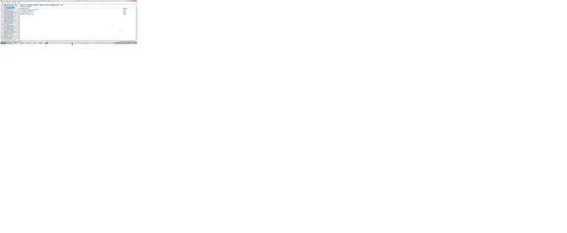

changed the plugs and the coils. took car out. did not throw a CEL but there was an obvious misfire or something going on. car ran good other wise but getting on it at one point it shuttered almost like it was cutting out.
Checked on the durametric and it told me no fault codes...but when I looked at the ready status section I saw this. Any ideas, thoughts, help, etc?

Well, I hav4 tried every way to Sunday to get this picture to work but basically when I click on the ready status it says
Catalytic converter efficiency - Failed
Fuel Tank Ventilation - Failed
Secondary Air System - Pass
Oxygen Sensors - Pass
Oxygen Sensor Heater - Pass

I took it back out and really jumped all over it. It did not miss or stumble on a 30 minute ride like it did right after I replaced everything. Plugged durametric back in and still no codes but still showing under the ready status ...
What do those things mean??

trimer,
Did you disconnect your battery or reset trouble codes using your Durametric recently?

trimer,
Reset fault codes for the misfires a couple days ago. Installed the plugs and coils today. No more fault codes just what I have listed in the ready status.
It will take a few driving cycles and a few miles for these systems to verify status after a reset... Just drive your Boxster a few more times and the Catalytic converter efficiency and Fuel Tank Ventilation will complete the self check. It could take 60 miles or more of driving, and a few start-up/warm-up cycles.
