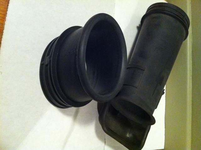

You could be right. It might be that I need a snorkel back in to give me this. But it is so far down stream of the MAF and in front of the filter... That I wonder.
I have my own snorkel in there now ....here is a picture of it versus stock. It is a big difference!
It may be that my intake pipe is to turbulent.
