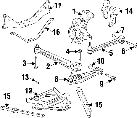

Ok so going in to install the new o2 sensors I found that the shop that did the install of the headers didn't tighten the transaxle cover. I am missing a bolt. It is one of the two at the front of the pan. Can someone tell me what size they are? Maybe a part number? Thanks guys. Trying to keep things ship shape.

Take a look here so you can pick your year:
Porsche Boxster Axles & Bearings - Page 2

Thanks Eric. Unfortunately I tried quite a few of the parts diagrams, but the bolt is not shown. It appears to be an m10 bolt with flange. I may just take the one off and go to the parts store. I was just hoping to get one while it was still on the lift.

Hey mark, no it the pan under the trans. It has two bolts fore and aft as well as two nuts on each side the connect to the cross braces. I am trying to find a diagram to reference, but having no luck this morning.

The triangular shaped pan, part number twelve. It's the two bolts at the front.

Hey, it's cold, snowy, and I'm off today..........or at least I thought I was. In any case, they are M10 bolts on the reinforcement plate, and torque to 34 ft. lb.

Off the top of my head, I don't know the length, but they are all the same in the plate, so you can check one of the existing ones for length. But it is a M10 bolt.
Old 01-26-2013, 08:44 AM   #13
Posts: 6,684
Try an M10X1.5X45

10mm X 1.5 X 45mm + about 4mm thick washer

Got it done. Thanks to everyone for the help.
