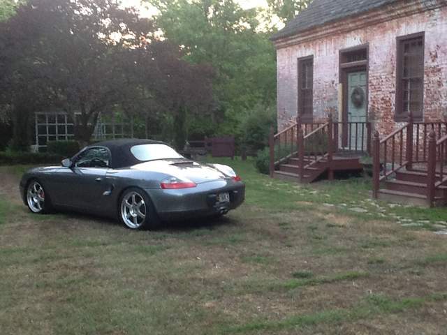

http://986forum.com/forums/uploads01...1369615838.jpg
Another pic

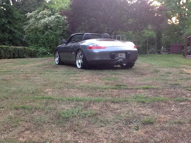

http://986forum.com/forums/uploads01...1369615971.jpg
And A final pic for your enjoyment. Hope these are good enough to help others who are on the suspension fence decide which way to go.

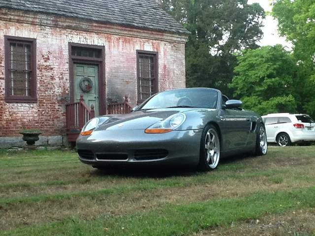

DFW02S 05-26-2013 08:13 PM
Originally Posted by sgt brad (Post 344465)
http://986forum.com/forums/uploads01...1369615758.jpg
This is today with new bilsteins and h&r springs/sways
This pic looks like it was taken in England, not Sweet Home.
sgt brad 05-27-2013 02:32 PM
It is my dream home. The house was built in 1830, is 2 miles from the Tennessee river and adjacent to a 200 acre farm. Makes a great back drop for pics as well. Fwiw we do have a small English garden
jaykay 05-27-2013 04:12 PM
What: size wheels; offset; spacers before and after???
sgt brad 05-27-2013 07:48 PM
Volk te37 forged 18" wheels. Fronts are 8.5 et49. Rears are 10 et42. The rears weigh less than 20lbs ea and the fronts are right around 18lbs. I love them. Perfect offsets too. I went through Johnny danger first to verify fitment. He was spot on. 235 and 275 fit with no issues at all.
