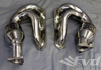

Shadrach74,
Here's the answer to all of your header/cat exhaust woes . A set of custom fabricated headers and precats from M&M Exhaust in Germany. They feature longer, equal length primaries with 2.25 diameter piping, along with an F1 style merge collector and HJS 200 cell trimetal cats - beautifully made from T316 stainless steel . Net hp increase - probably somewhere in the range of 8 to 10 hp at the wheel . Cost - approximately $3800 . Aggregate cost- about $300 or so per hp .

I'm starting to think you just have a Woodrow Wilson for Chinese goods, my pipes were equal length, metal was T304 stainless, merge collectors were the same, pre cats? Not a problem for the 2.5 people. The only thing I see is a higher price.

Look at them again . They probably seemed like they were longer, equal length primaries with a real merge collector. And, worse they were probably less than 1 5/8 in diameter .
