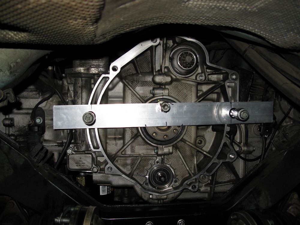

Brace
Probably at this point you should at least brace the main shaft... just a measure of assuring things don't move. I used a piece of aluminum as shown. As far as the IMS shifted in the hole. In my case it went back to center pretty easily once the cover was put on. I did use a screwdriver to help it along. Gently press it against the thick part of the engine case.
It will go on.
