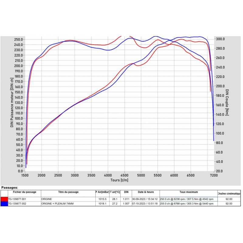

Now that some time has passed. Any luck with some dyno runs? Curious to see the numbers. Definitely interested if theres some good gains and they come back in stock.

Not really unfortunately, I've been too busy building the company for the last 6 months :/
I have a customer that picked up around 30Hp with the plenum, exhaust, and a tune on his 2.7L 986.
Right now I'm testing the 996 version. it still needs a bit of work...
I had a youtuber that was supposed to come (piston Kirk) but due to COVID he couldn't make it. We'll see in the winter if he can come and we'll do a back to back dyno with the plenum installed and removed.
Ben
