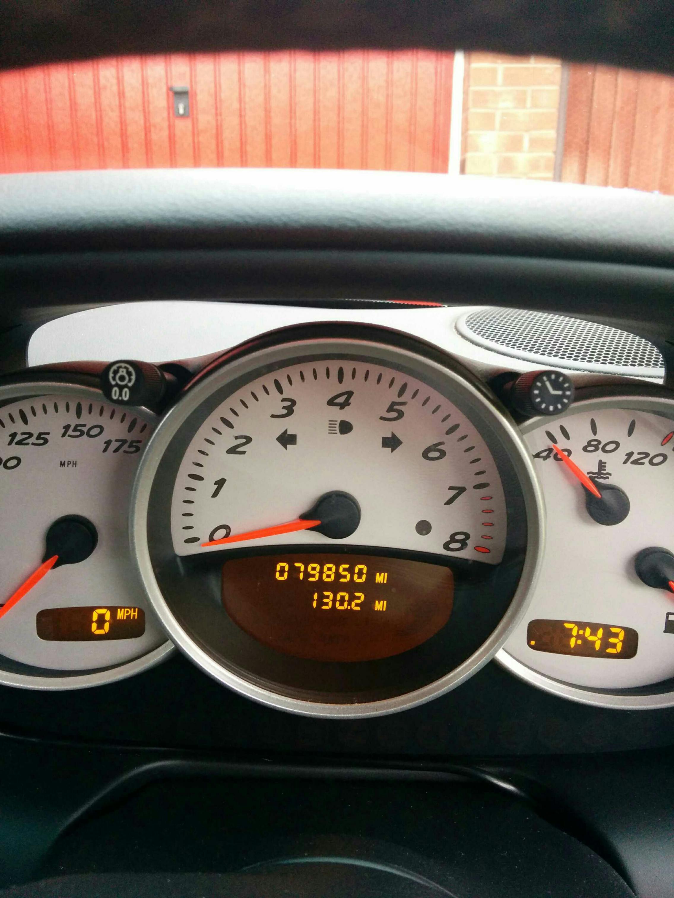

That's strange, I have the 3.2 S but no dot matrix display Al La picture : Name:  uploadfromtaptalk1400784249021.jpg
What's going on here as I'm about to add the OBC loom & switch
Any idea's ?

OK I have my stalk, my Tech turned the function for OBC on when he did a diagnostic of the car after my wreck....how difficult is it to install the OBC Stalk ??
Dwight
PS Danch , you have the same display I do
Dwight
Just the obc stalk takes about 20 minutes for a first timer like me, got to install the loom I made next & then get the obc function turned on but I'm doubting things now as my display doesn't look like the others
