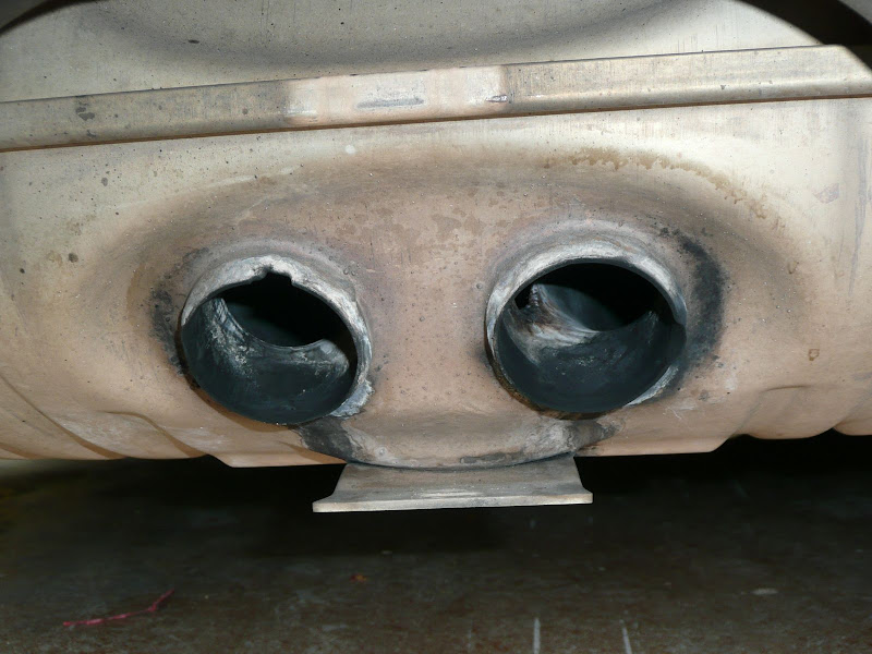

My theory is this. The inside of a 986 muffler has the exhaust going from chamber to chamber before exiting, what if I could decrease the amount of chambers?
See image below, the RED is the where the exhaust comes in, and then it goes to AQUA, before existing via the TAN.
My mod is allow fumes to exit much faster by opening the exit pipes to the first chamber, see the GREEN line.

Now drill away:
http://lh6.ggpht.com/_9sTq_sN1KDw/Sa...2009%20010.jpg
Both sides should be drilled into and then would look like this:
http://lh6.ggpht.com/_9sTq_sN1KDw/Sa...2009%20004.jpg

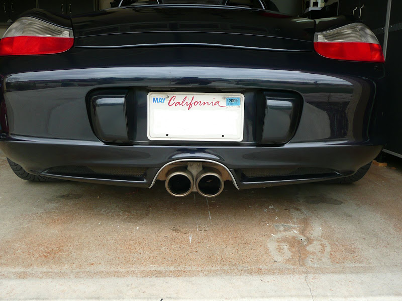

Install Tips back on, after cleaning of course…and enjoy the new throaty sound without the deafening/annoying drone!!
