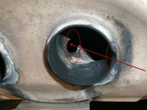

crios 04-14-2009 04:24 PM
Center punch as suggested by blue2000s, or/and you'll have to push in and to an angle, agaist the wall to use as leverage, leaving some cuts on the pipe. You can also cover up the drill with ducktape where it hits the wall to help prevent these cuts. Go slow, into you establish a groove where the drill will stay in place.
See pic below:
