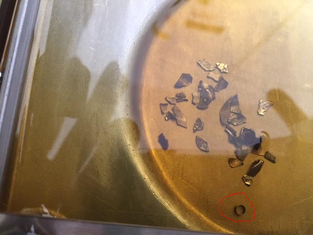

AZ986S 09-08-2017 12:11 PM
Well gents, bad news. This is probably my issue.:eek:
Haven't looked at the filter yet.
The funny thing is the engine ran strong and still runs strong.
These particles are magnetic, so iron or steel.
Also there is a tiny little spring that I circled in red??? Variocam?
Any ideas as to what this is? Valve spring retainers? Looks like ribs on the particles.
http://986forum.com/forums/uploads02...1504897147.jpg
(http://986forum.com/forums/uploads02...1504897737.jpg
http://986forum.com/forums/uploads02...1504897181.jpg
The good news is it's early in the season:
Rwc94303 09-09-2017 09:04 PM
If these particles are what they look like to me I don't know how this engine is still running! Yes, valve spring retainers and keepers plus that little spring (I think it's from a valve stem seal).
Take it apart before you touch the starter again.
Good luck!
jsceash 09-10-2017 04:03 PM
I have to agree the small pieces with the ribs are valve keepers.
AZ986S 09-10-2017 07:59 PM
Looks like that is the case. The other pieces to me look like they are probably either the spring retainer itself or the the hydraulic lifter. Either way, there is probably a bent valve and possibly more damage, so the heads are going to come off I'm sure, and, if the engine is salvageable, I'm probably going to upgrade to racing springs, retainers and keepers.

There's a post on Rennline that discusses the possible cause for this happening. It seems like the bottom line is that Over Reving causes the valves to "float" and impact the piston, especially with high RPM operation such as DE or racing. These are made of sintered powder metallurgy, and are brittle. The spring tends to soften up with age and this adds to the problem.
I'll be talking to one of the Phoenix area Porsche racing specialists (Patrick Motorsports) tomorrow and see what they say:(
