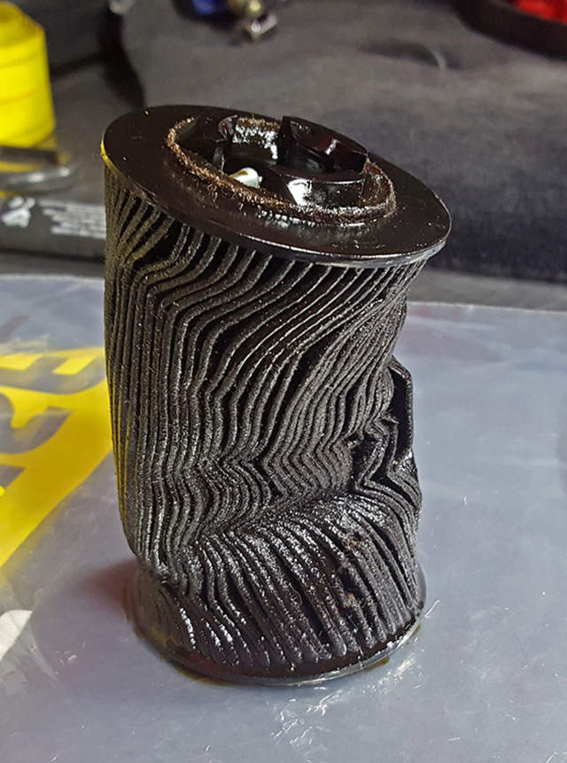

Here is the oil filter from the failed engine just as it came out of the engine. It looks like the oil pump was sucking so hard that it collapsed the filter. Is that possible? Weird. :confused:
There wasn't any metal in the oil or the oil filter but the shop said that they found coolant in the oil when they drained it. There is also a ton of oil in the intake runners. I plan to get the engine back to my workshop and will disassemble it to try to determine the exact failure.

Quadcammer 04-27-2018 11:57 AM
blown AOS resulting in a broken ring?
seningen 04-27-2018 03:52 PM
I'm thinking that's the case -- was there any smoke out the back?
Mike
911monty 04-27-2018 04:40 PM
Let's try this one. Cracked cylinder/head #4/5 ? resulting in coolant in the oil. Oil filter is downstream of the oil pump so sees pressure not vacuum. Coolant saturated the paper filter media which swelled closed causing high DP across the media resulting in element collapse. Excessive vapor from coolant in the crankcase overwhelmed the AOS resulting in failure.

AZ986S 05-01-2018 12:31 PM
Failure mode #???
Yeah was going to say filter is post pump. I can’t think of another way that the oil filter collapsed other than it absorbed coolant/water. These are not designed for separating water. Maybe a synthetic media filter would have done better? I.E. spin on.
The other question is: did the coolant in oil make the AOS fail? Funny that there was no smoke but there was a ton of oil in the intake...
I’m thinking more and more that the AOS didn’t fail, that is was just oil starvation caused by the crushed filter, destroyed / spun bearing somewhere?
Topless 05-01-2018 08:22 PM
I'm guessing failure of the engine oil cooler or an internal freeze plug causing intermix> collapsed filter> blown AOS> Oil in the intake. The motor is full of goo but if no metal debris it may be salvageable.

Smallblock454 05-14-2018 10:10 PM
Some news what caused the engine failure? Oil filter looks pretty trashed. What brand was it?
