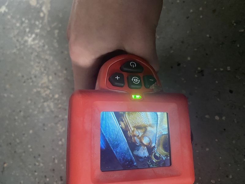

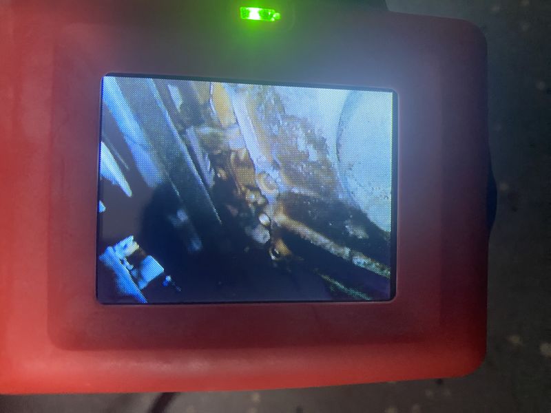

Currently I'm sitting at the point where 80k miles has gotten to the car, and maintenance items are going to need doing soon. I've been noticing that the car sounds like it's been cammed at idle, and a faint ticking sound can be heard similar to valve ticking in older cars. After a lot of overthinking I took a camera snake and looked at the undercarriage for any oil leaks because of the IMS. First off, is replacing the IMS urgent as of now? and If not, when should I start worrying about it?
Below are the photos of the undercarriage, specifically of the transmission-engine area

At that mileage, your tensioner wear pads are probably done. Do you have a means to check you cam deviation.
Do you check your filter at oil changes for debris?

An oil leak in that area would be from the RMS (Rear Main Seal) most probably and you'd do both the IMS and RMS at the same time because uncliping the trans is 1/3 the effort of doing the IMS only. Use the updated RMS.
Examine the oil filter and any debris there should tell you your priorities.
You don't say what year your car is and that matters.
