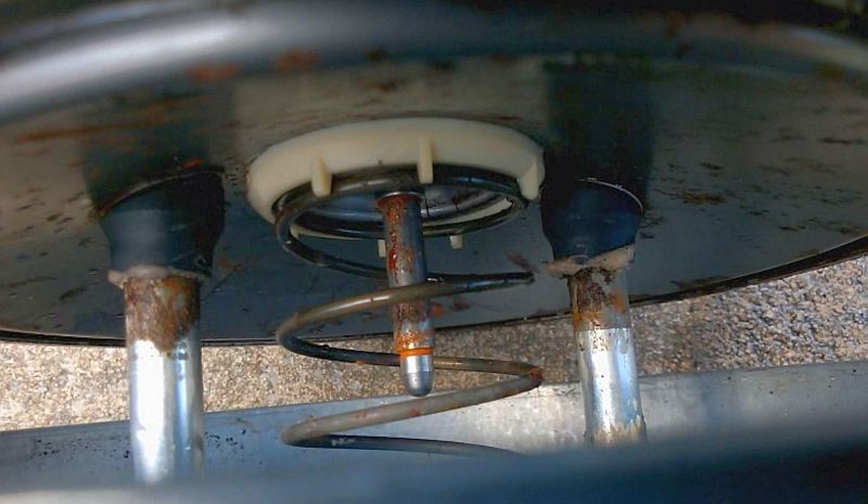

I agree that the brake booster is not the likely culprit at this point. I'll add that when mine was bad, I pulled out the vacuum tube and looked inside with a cheap borescope. With a flashlight you could probably observe some condensation inside.
Removed and opened:
