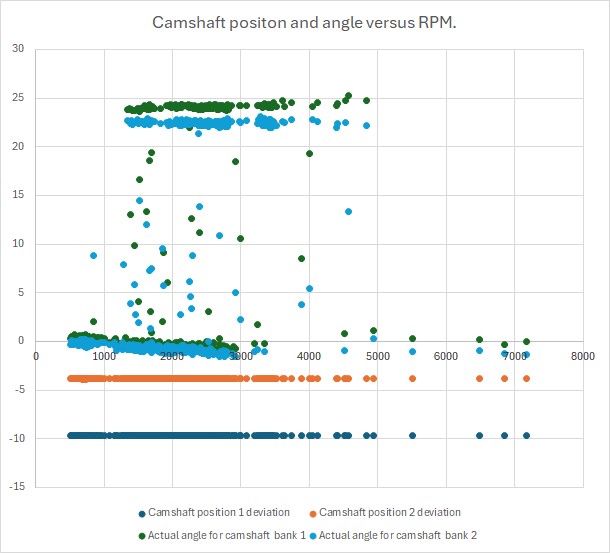

Next I took the Durometric and started data logging and took the car through my test loop, which is about 50% secondary roads, and 50% highway with a couple of engine pulls to redline on the entrance ramps.

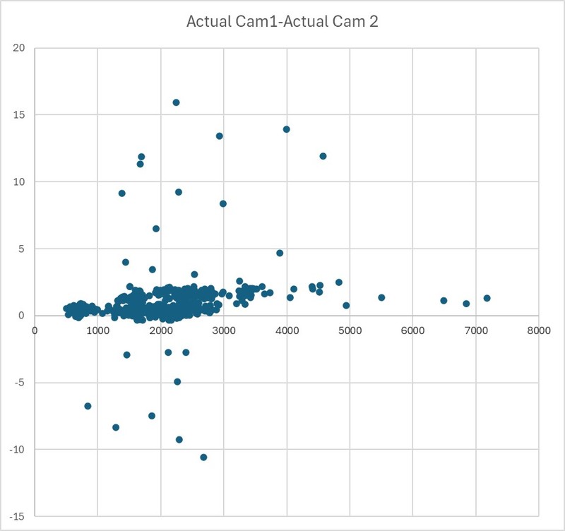

I pulled the data out to Excel to see what is going on. First I compared the two camshaft positions to the the engine's RPM.
Than I compared the 2 sides to each other by subtracting the cam2 angle from the cam1 angle for each data point.
In both cases, it seams clear that camshaft 1 is generally about 2-3 degrees higher than camshaft 2, especially when they jump to the ~23 degree setting. Also the "Camshaft position 1 deviation" is obviously about -9.66 degree, but that seems to be more of a flag value that is set rather than a specific measurement. It stayed consistent throughout the test across all of the different engine conditions. The camshaft position 2 deviation is -3.86 degrees, and also consistent in all phases of operation.
Never the less, it seems like the camshaft 1 solenoid system isn't working (given the test at idle)

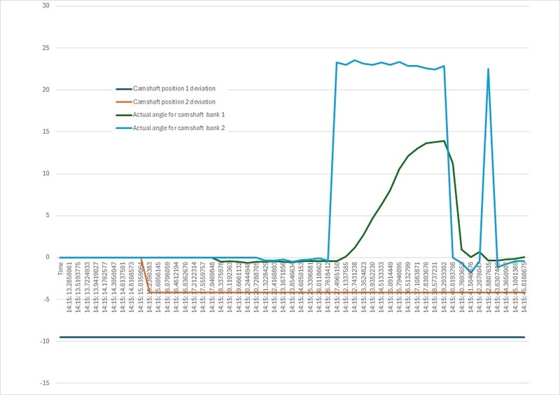

Something seems off, because the actuator shifts at 2500 rpm and 5500 if i remember correctly, so all your data points below 2500 and above 5500 should fall around zero, while the data points between 2500 and 5500 should be around 23-24. That's clearly not the case.
However, I think both solenoids and actuators are working, because what happens is fairly similar between both banks. So, somehow, they are synchronously bad. Perhaps there's a broken wire somewhere which somehow affects both actuators.
For cam angle values over 20 the values clearly separate, which probably means one bank is not able to move the timing to the target range, probably because the chain pad is shot on that side.
Can you arrange the dataset in a time dependent manner?
Like this?
I think I see that you're saying.
1) They are clearly separated at the 20+ degree step. I'm guessing that it's the intake cam being advanced.
2) Also, it also doesn't look like they are moving together when they shift from the nominal 0 level the 20 degree+ level. This may be a time phasing issue since I wasn't taking a gazillion data points. It looks like the logger was capturing a data point every ~1.3 seconds.
But it looks like it's definitely the ramps.
I guess my project is now to replace them and run another set of data to confirm the solution.
Good point. It seems like the variocam is kicking in about 1000 RPM too low, and turning off about 500 RPM too low. Doing a web search, it looks like the actuation of the variocam is dependant on RPM and load. At lower engine loads, the actuation of the variocam is retarded. Under higher load (such as an entrance ramp engine pull) the actuation is advanced. Initially when accelerating from my driveway and a nearby stop sign, the load was high. Than I was cruising on a 2ndary road with 1 stop-light, in ~3rd gear, so no variocam was activated because the load on the engine was light.
It definitely seems like bank 2 is not advancing as much as bank 1. I guess the variocam system advances the intake cam by 13 cam degrees (or 26 crank degrees. I'm guessing the system measures everything in crank degrees). So the bank 1 intake cam appears to have lost about 1 degrees of advance, while bank 2 seems to have lost about 2 degrees of advance. So maybe bank 2 is the real problem(?). Or is it that both sides are retarded (i.e. 1/4-1/2 degree of wear on the tensioner ramps for the long chains, or the chains themselves), in addition to 1-2 degrees of wear on the variocam ramps?
Either way, I'm going to replace the variocam ramps on both sides while I'm under the car.

Yes, plotting the cam angles in the function of time is more infomative. The graph looks fine, actually, apart from that separation in the high cam angle value ranges. I'm not sure about the load dependency, I usually check these in neutral. In those conditions, when revving the engine over 2500 rpm, the variocams keep the cam angle at around 25 degrees. So I would think your value (22) at bank 2 is showing a malfunction. Which is weird, because your fault code is at bank 1. But that code can be due to your high deviation value also on bank 1. Nevertheless, you need to pull both cam covers and replace all four pads anyways.

Yes. I was thinking, why am I geetting alarmed for a Bank-1 error when bank-2 seems to have more wear?
Possibilities?
1. If you look at the "Actual Cam1-Actual Cam2" graph, you'll notice that the data is skewed towards the positive side. This suggests that cam1 is more likely to have a larger value than cam2. You can also see this in the distribution of points away from zero. I wonder if the Bank1 exhausr chain variocam unit is slow to return to 0 (and needs to be replaced).
2) Why does Cam1 have such a large negative deviation number when we don't see it in the numbers. My suspician is the Porsche may be more sophisticated than we give them credit for.. I suspect that "Deviation" is not just a reference name, but rather a statistical deviation calculated within the DMU. If this is the case, than enough data points far enough from the mean will trigger the alarm. I'll have to check this in the data when I get home.

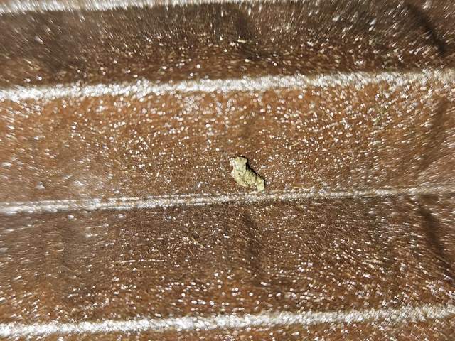

In other news, I cut open the oil filter from the last time that I changed the oil in the springtime, and found a couple (2, maybe 3) of these in the filter.
I drained the oil from the car yesterday and changed the filter again, but I haven't had a chance to open it. I also pulled a sample to have lab tested. I'll post what I find in the filter this time around in a couple of days.

It's also strange that the deviation on bank 2 is not steady. Looking forward to seeing what you find. Btw, the actuators are testable when they are out, and rebuildable as well.

A turn for the worse
Here's the contents of the oil filter that I pulled out of the car on Saturday.
Greenish-yellow bits everywhere! My understanding is that this is from the seals of the chain tensioner. I guess there is no avoiding it -- it's time to replace the tensioner.
