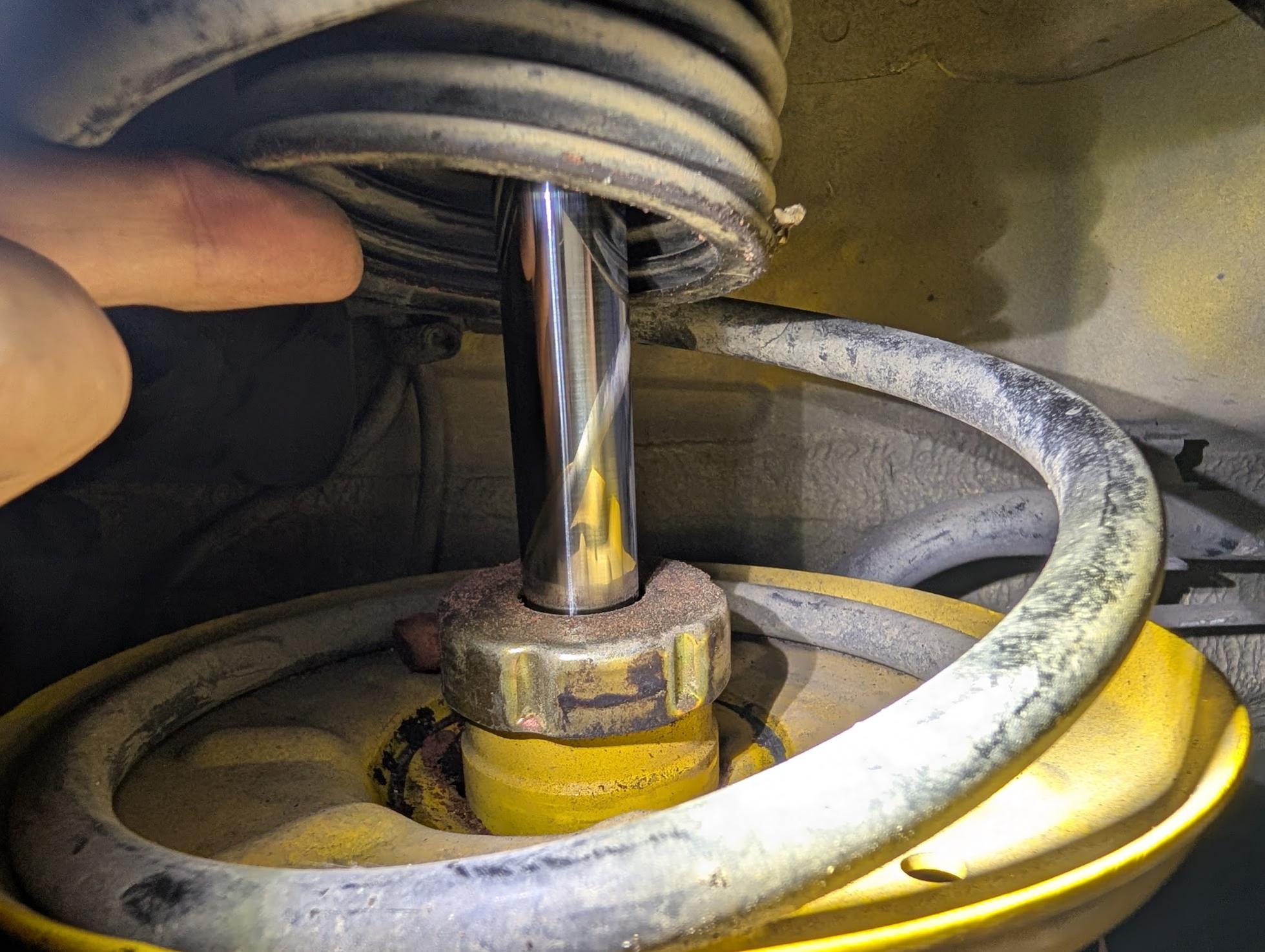

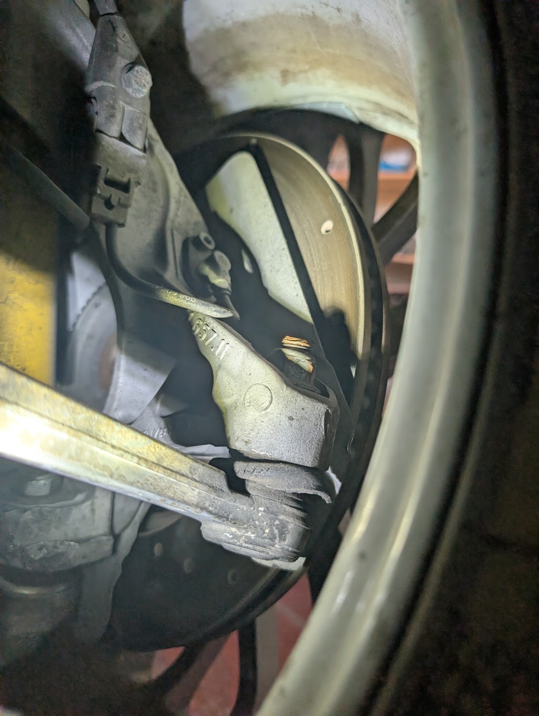

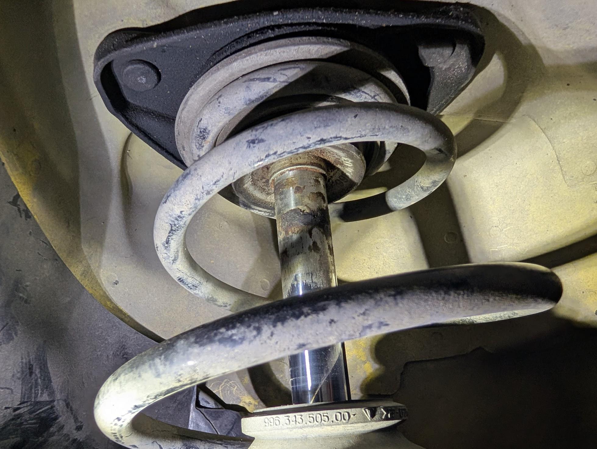

I had a chance to jack the car up today and get some pictures and videos of the suspension components. I would hugely appreciate if anyone could take a quick look at the uploads and let me know if they agree that the struts need replacing along with all the other components mentioned above. I don't mind doing it if needed, just money is tight and I don't want to replace things that don't need replacing.
I did spot some super suspect tie rod ends, to my untrained eye they look completely shot ( pictures also uploaded with the others ). Is it possible that these could be the cause of my steering wheel shake at 70mph?
The pictures and videos can be found here.
Thank you so much in advance to anyone that can take a quick look.

In case folks are not wanting to click into the Google photo album I've uploaded a few of the pictures here if it's easier ( there's a load more in the album, and some video ).
These are the tie rod ends, and then an example of one of the struts.
Thank you again!
