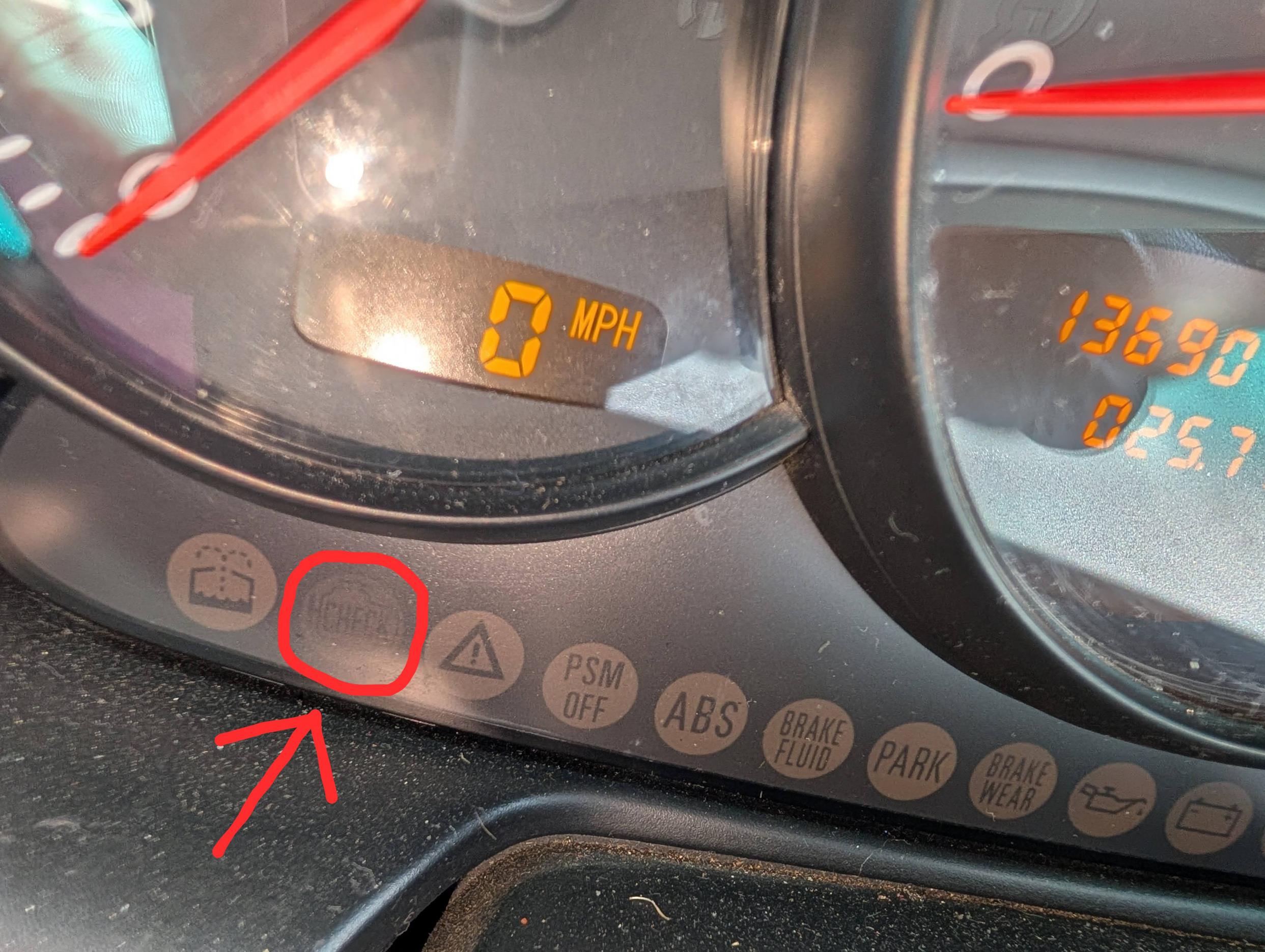

I actually just noticed something this morning as I sat pondering this with the top down. The check engine light on the cluster looks physically different than all the other lights. They are all OFF in the picture below, but the check engine light looks "different" and "darker than the others.
Is it possible someone taped over the plastic on the backside ( or used something else to prevent the light shining through )?
Does everyone elses look like this and I'm just going nuts?

It looks like they may have taped it from the back. Pretty easy to pull the cluster and check. BTW, I sent you a PM regarding your rear window thread.

Typically its not the "check engine light" they look for, its the fault codes stored in the computer. Certain fault codes may not come back right away if you clear them. I've heard you can get enough "history' to pass emissions in a couple of hours and some brief highway runs, though I haven't verified this.
It's not terribly complicated to disassemble the cluster and see if someone blacked out the CEL spot. Be sure to drill a hole in the top to release the tab of the front bezel. You'll see what I mean if you get there.

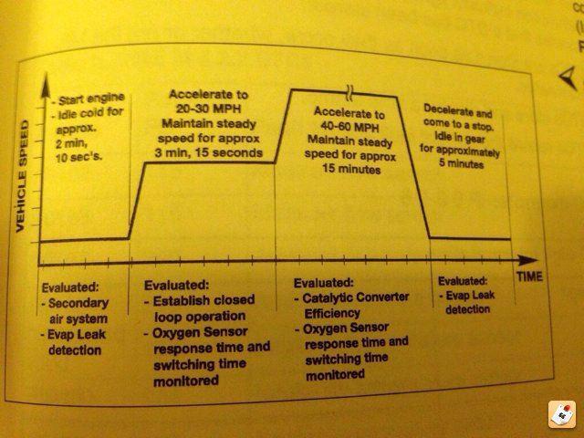

I had to erase my codes after replacing a bad O2 sensor. This is what I did to get the sensors to register. I was blown away that it actually worked.

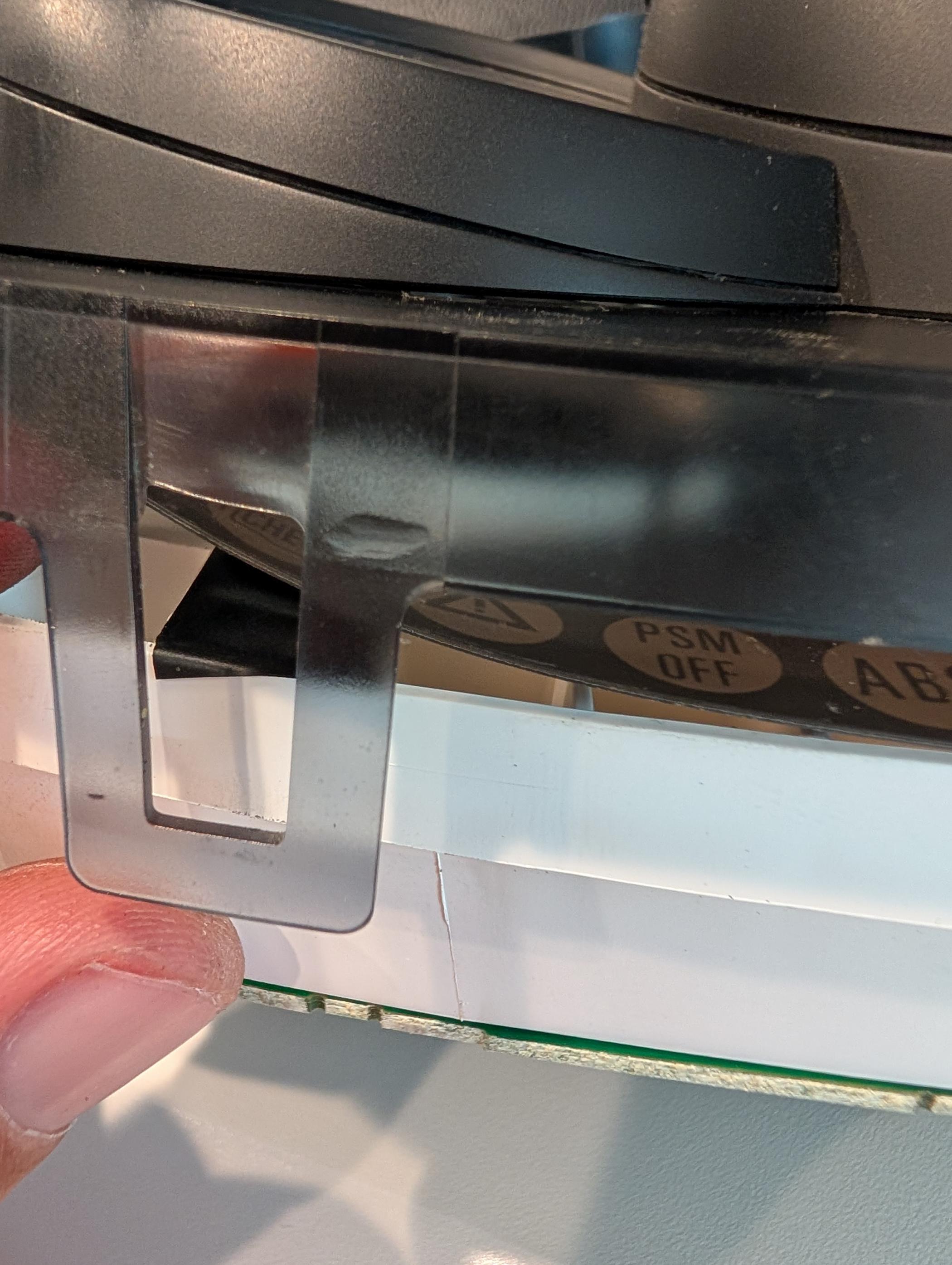

Mystery solved...
