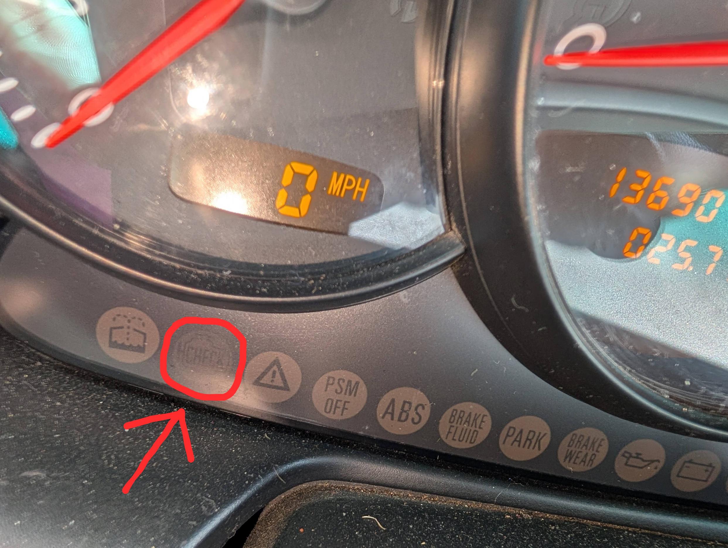

I actually just noticed something this morning as I sat pondering this with the top down. The check engine light on the cluster looks physically different than all the other lights. They are all OFF in the picture below, but the check engine light looks "different" and "darker than the others.
Is it possible someone taped over the plastic on the backside ( or used something else to prevent the light shining through )?
Does everyone elses look like this and I'm just going nuts? :confused:

It looks like they may have taped it from the back. Pretty easy to pull the cluster and check. BTW, I sent you a PM regarding your rear window thread.

It's not terribly complicated to disassemble the cluster and see if someone blacked out the CEL spot. Be sure to drill a hole in the top to release the tab of the front bezel. You'll see what I mean if you get there.

Mystery solved... :mad:

I've heard of unscrupulous dealers/sellers doing something like that. I've even heard of lazy ones taking the smallest-diameter drill bit and drill through the cluster to break the light.
But there is one simple, free trick all buyers should remember: Put the key on, engine off and look for the check engine light. If you don't see one, run away. A better way is to bring a scan tool, even a cheapo from Harbor Freight, that can display IM readiness. This way you'll know if they cleared the codes before you got there.

Now the interesting question: was/is there a reason to blacken the CEL?
BoxsterInTheSun 07-01-2025 10:30 AM
Absolutely.
More codes than you could shake a stick at.
It's taken me 6 months to straighten it all out so I could get it registered here in CA, but it was a good learning experience for me and my 15 year old son, and we did all the work ourselves so it wasn't astronomically expensive.
