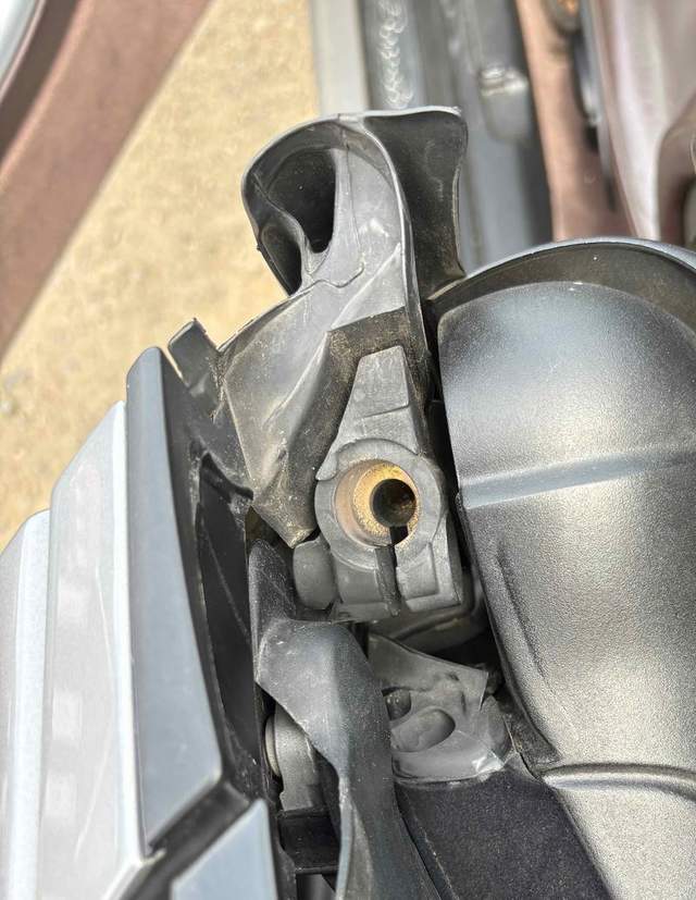

I had the top down yesterday and see something is missing on the left side, where the door and the body come together.. The photo shows a hole lined with brass or bronze. Looks like plug of some sort used to be there. The right side plug is in place. I didn't remove the right side for a closer look, just in case there is more to it than just a simple plug. Does anyone know what used to be there and what the part number is for a replacement.

There's an optional part that goes there to mount the hard top. Most cars came without them and had the plastic plug installed in it's place.

For future reference, the part number may be 986-561-655-00.
... and humps.

I bought a couple of extra one years ago....I discovered that one of mine somehow popped out and lost on the road......one of the least expensive Porsche parts I ever bought.....LOL
