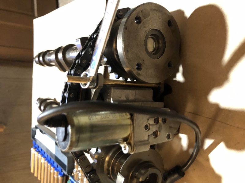

Posts: 545
Got the compression tool this afternoon. Never one to work on something out in the shop when I can work on it inside in front of the TV and near snacks, I brought the cams in for the procedure. I ran into a problem right off the bat: My deep socket set only goes down to 9mm. I needed an 8mm, so I pressed an 8mm box-end wrench into service. It worked well until pressure caused the nylon washer under the nut to bulge, to the point where I can't get the wrench on it. If I had an 8mm deep socket I could probably bear down on it enough to seat the socket on the nut. As to why the washer accompanying the nut is made of nylon instead of brass or steel, that's a good question. Only two solutions to the problem, as I see it: (1) scare up an 8mm deep socket somewhere, or (2) use a metal washer under the nut. I lean toward (2), unless there's a compelling reason why I shouldn't. I invite your input.
Also, it's amazing how ingrained right-hand thread operation is. A half-dozen times I caught myself turning it clockwise with the intention of tightening it and groaning when I noticed the nut was traveling up the rod instead of down. When I consciously turned the nut counterclockwise to tighten it, it felt... wrong. And weird. I suppose I'd get over it after a year or two, three years at most, of working with left-hand threads.

Posts: 545
Unless I hear a "Don't do it," I'm going to find a small metal washer to use under the compression tool's nut instead of the nylon washer. I'd like to get those new pads in while I'm still young (relatively speaking).
Do it. It won't harm anything except maybe mar the surface a little, but it won't affect the tensioner or chain's function in any way. It seems to me like that hole has only one purpose, anyway, and that's for the tool. Maybe put a little oil between the washer and the nut.
Thanks, Al. A friend is coming over later with his flat washer assortment, since I don't have any washers that small. And oil is a good idea.

Posts: 545
The work stoppage caused by a small flat washer didn't catch me by surprise. By now, I've come to expect it. It's a Porsche, after all. I'm used to having the wackiest stuff happen, things that made me cock my head to the side like a dog listening to an ultrasonic whistle. Don't get me wrong, I love the car. I especially appreciate how it handles. I've had 911 owners sneer at it, as they are inclined to do, but they blow a fuse when I suggest that the mid-engine design gives my 986 superior weight distribution and more predictable handling than a 911. They don't like that one bit. Not that I wouldn't have a 911. (Or ideally, an all-wheel-drive 959, which has the same rear-engine form factor.) However, I'm totally satisfied with my 986. I figure encountering oddball stuff while working on it is part of the cost of owning it.
