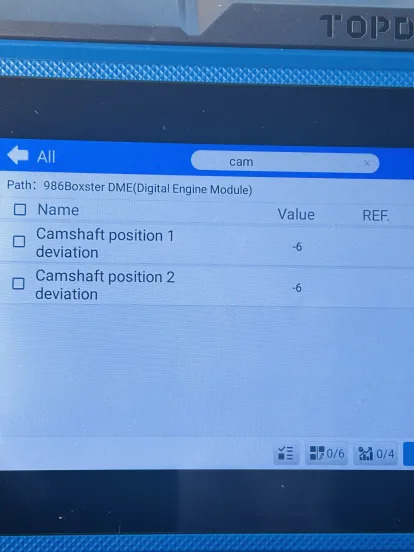

figured id drop this here as good news for the AD600s. decided to say screw it and buy one for next day delivery. setup took no more than 2 minutes and downloaded the porsche specific driver / option to try on my 1999 Boxster. i personally dont care for auto vin so i just quickly selected: manual - 986 boxster and was all set. from there i went to the live data section and searched cam. to my surprise it popped up both banks instantly. not sure what the good values are for cam deviation however mine sat at -6 even after a good drive. needless to say the AD600s is VERY easy to use and porsche 986 friendly. updating was no problem, connected to wifi took seconds, reads codes and live data really well
edit - one thing i DID notice, not a huge issue though something to consider. the OBD port doesnt sit entirely flush with the one in my boxster, meaning it was prone to disconnecting itself very easily and putting a pause to any diag. you will hear a beep if it does so thats good to know in the event that your data suddenly stops. could be why some data for people on this thread may not have been entirely accurate ? not sure just something to add. i still recommend despite that minor thing

okay i have an update and it is very good news....
Thanks to 78F350 as it gave me exactly what i needed to explain to the tech support guy in China.. I sent them his images and what i was seeing. i also uploaded a log of my device. Apparently it was due to a new android version and all the manufacturers conversion files they had to rewrite because of this.
They quickly sent me a patch file with the corrections and i was able to load it.
I was at Porsche 2.50 and went to Porsche 2.51
so now i am able to read this.
I hope this helps someone in the future...
