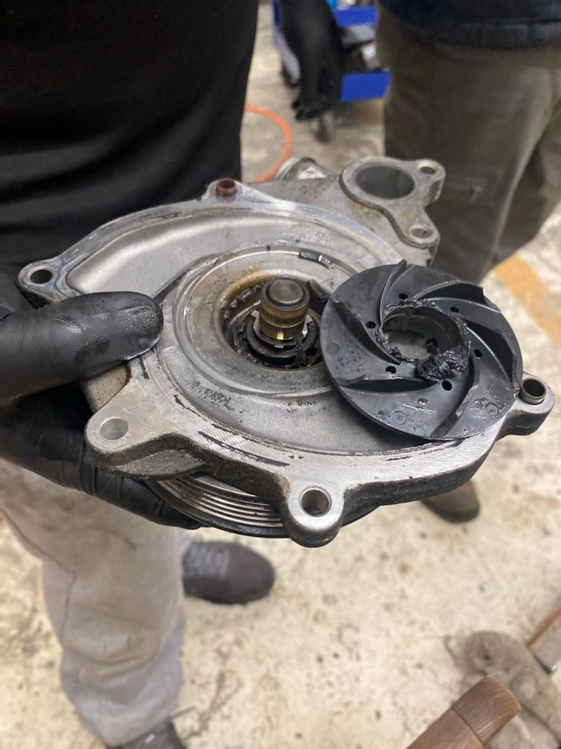

I was almost home when I looked in the rearview mirror and noticed to my horror that I was trailing antifreeze. A lot of it. "Split hose," I sez to myself. I made it home without the temp in the danger zone. When I got under the car to have a look-see all the hoses looked fine, but antifreeze was dripping from the water pump.
I had to remove the panel behind the seats to obtain access to the top four bolts on the water pump and the serpentine belt. First, however, I had to finish draining the system, including the heater core. After removing the serpentine belt (which looked fairly new, btw) I managed to get the water pump and thermostat (I decided to also replace the thermostat as long as I was in there) off with only a moderate amount of swearing. Inspecting the water pump, I was instantly suspicious that maybe, just possibly, it was bad:
The impeller looked like it had met a bear with a taste for plastic. I bought a new water pump, thermostat, and of course gaskets. Installing the new parts was fairly straightforward, although I'm probably the slowest mechanic on the planet because I'm meticulous to the point of it being OCD. I started in the morning and it was nightfall by the time I got her buttoned up again. Two kibitzing neighbors, whose legs and feet you can see in the photo, had abandoned me long before that. Lightweights.

LoneWolfGal, first of all congratulations on your first repair!
Now that you become more intimately involved with your car, it will put a smile on your face every time you drive your car
I was surprised to see the melted plastic on the center of the impeller, you have to ensure to get all the air pockets out of the system to avoid any overheating issues.
The impeller's center bearing failed and got hot enough to melt the plastic. I flushed the system thoroughly before I installed the new pump, but saw almost no plastic pieces. Most of it fell out when I removed the pump. I appreciate the congratulations. Hope I'm as successful nailing down the EVAP system problem. Maybe then I'll have enough confidence in it to take a run down to Eugene, about 110 miles south of Portland. A friend of mine down there has a 911SC and wants to see my 986, which he called "a classic." I think he's right about that.

Porsche has declared the 986 a “Porsche Classic” and is supporting it inside their “Classic” division.
Keep an eye on your water temps.
It is possible, just saying, that parts of the plastic impeller have broken off and could block your smaller water passages inside your engine.

From what I’ve read there’s a good reason Porsche used a composite impeller and I would recommend replacing with the same type of pump.
