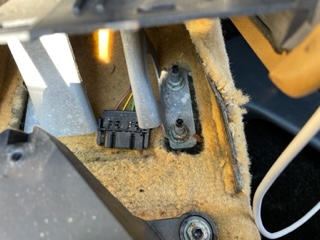

I took off my console to fix broken e brake switch and noticed two unused wire connectors. One just under front and one towards back. I assume they are for options I don't have but would like to know for sure.
Anybody know what these are?

I am almost certain that the connector in the first picture is for the cellular phone option that very few people purchased. (It’s a convenient source of power and ground for modifications such as an integrated garage door opener.)
I am not certain about the second one. Could it be for the light in the ashtray? Many people replace the ashtray with a small bin called the non-smoker option. (That may not be the precise name.) If a previous owner swapped out the ashtray, they would have disconnected the light.

Yes, front one is for the phone option:
Lower Centre Console Connector
The other is security circuit for the console compartment latch:
Mystery connector in console

Ding, ding, ding!!!
Thanks!
