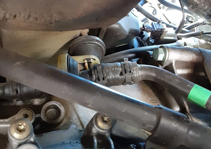

UPDATE...
A coolant hose going to a cooler/heat exchange(?) had worn out. There is a small puddle of coolant on top of the engine which I will take care of when I replace the hose. Too much excitement for the day. LOL
BTW, if anyone knows the part number for the hose, please post. Thank you.

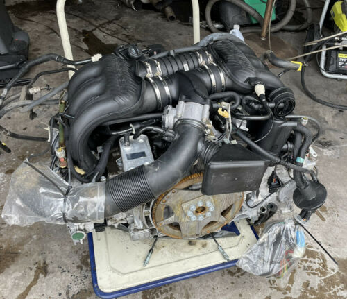

Belzy,
What year is your car?
You helped me figure out my problem was actually a ruptured hose. However, I was not able to find a heater control valve on my 2001 base near the coolant tank.
I've got this pic off the ebay. Is yours any different?
2001 Boxster base 133k
