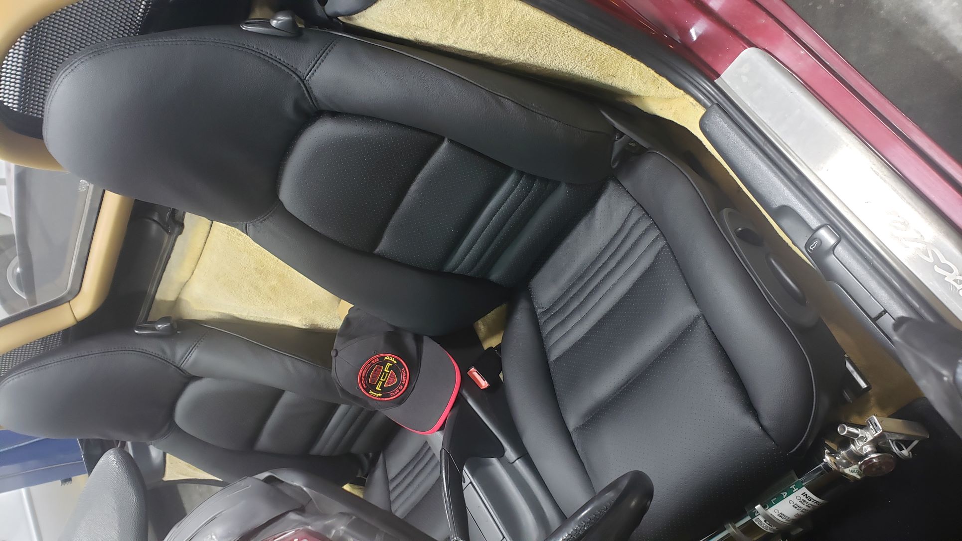

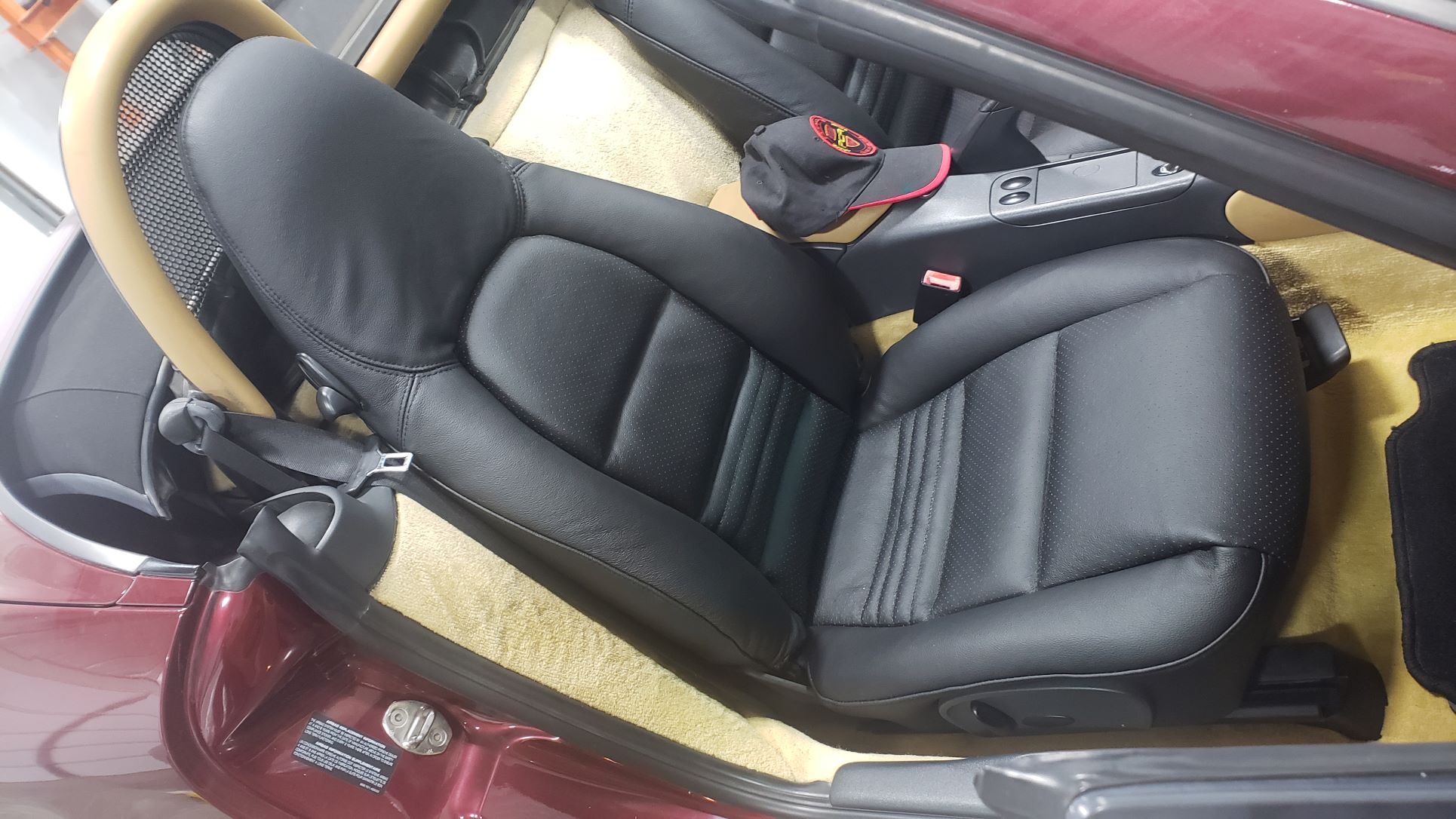

The seat is back together and it looks pretty good.
After all the effort that went into installing the cushion I was worried that it might pop off in the front so I screwed in a retainer to make sure it doesn’t move.
http://986forum.com/forums/uploads02...1641678504.jpg
The cut-out and installation of the seat back release levers turned out really well.
http://986forum.com/forums/uploads02...1641678547.jpg
I had problems with the installation of the panel for the seat controls. I think the new cover distorted the foam so that I could not get one of the top clips to engage. I ground about an 1/8th of an inch off the panel’s lip in the top rear and then was able to install it. Then I had to take it off again because the seat back recline control wasn’t working correctly (see below).
And here it is back in its natural habitat!
http://986forum.com/forums/uploads02...1641678606.jpg

Here is the passenger seat finished...
http://986forum.com/forums/uploads02...1642443755.jpg
... and the 2 seats installed.
http://986forum.com/forums/uploads02...1642443871.jpg
The difference in colour between the original "savana" and the "lark" inserts is noticeable but doesn't clash too much because they are not side by side.
I am happy! I'm curious as to how they will look after being used a bit.

78F350 01-20-2022 11:46 AM
Good work elgyqc. Most of the wrinkles should flatten out as you use the seat.

Overall quite pleased with the quality and fit of the Lseat covers. While not as high-grade as OE it is still decent leather. There are a few areas where the fit could be better and these may improve with use and some sun exposure. I suspect this wouldn't be an issue if the seat foam was new instead of being 24 years old and a little shrunken. For the price I think it is a great option. I wouldn't go this route for a restoration but for a driver/track toy it is great value for money.
Attachment 23320
Attachment 23321

Nice job ammonman, almost no wrinkles. Did you use a heat gun to remove the wrinkles?
ammonman 04-17-2022 04:03 AM
No heat gun yet. Something I've learned over the years working on a few upholstery projects here and there is you have to "give it a lotta love" akin to a deep tissue massage when installing new covers. Massaging the cover and foam in the directions you want the material to lay helps get it smoothed and stretched into place.

That is one of the best looking installs of the Lseat covers I have seen. It almost makes me want to tackle replacing the seat covers in mine.
