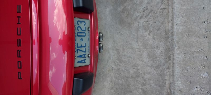

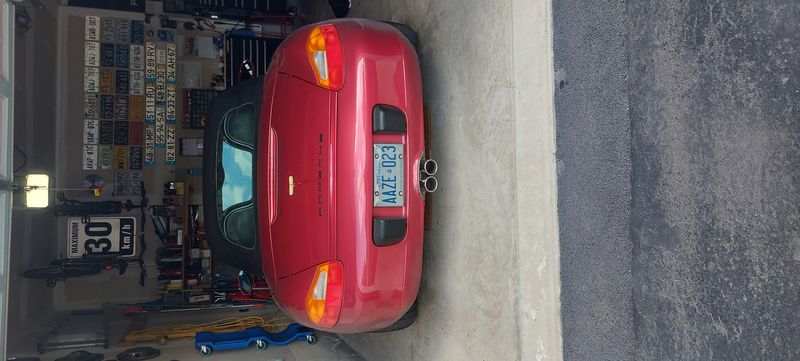

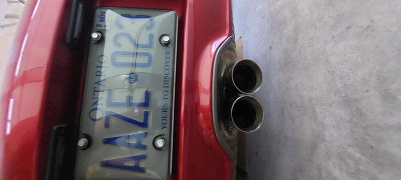

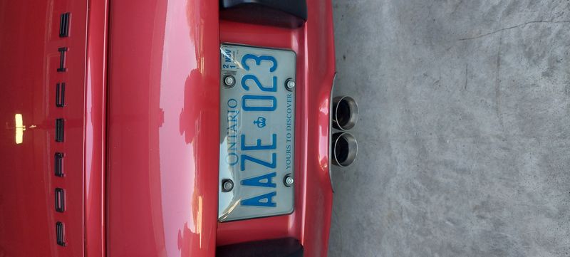

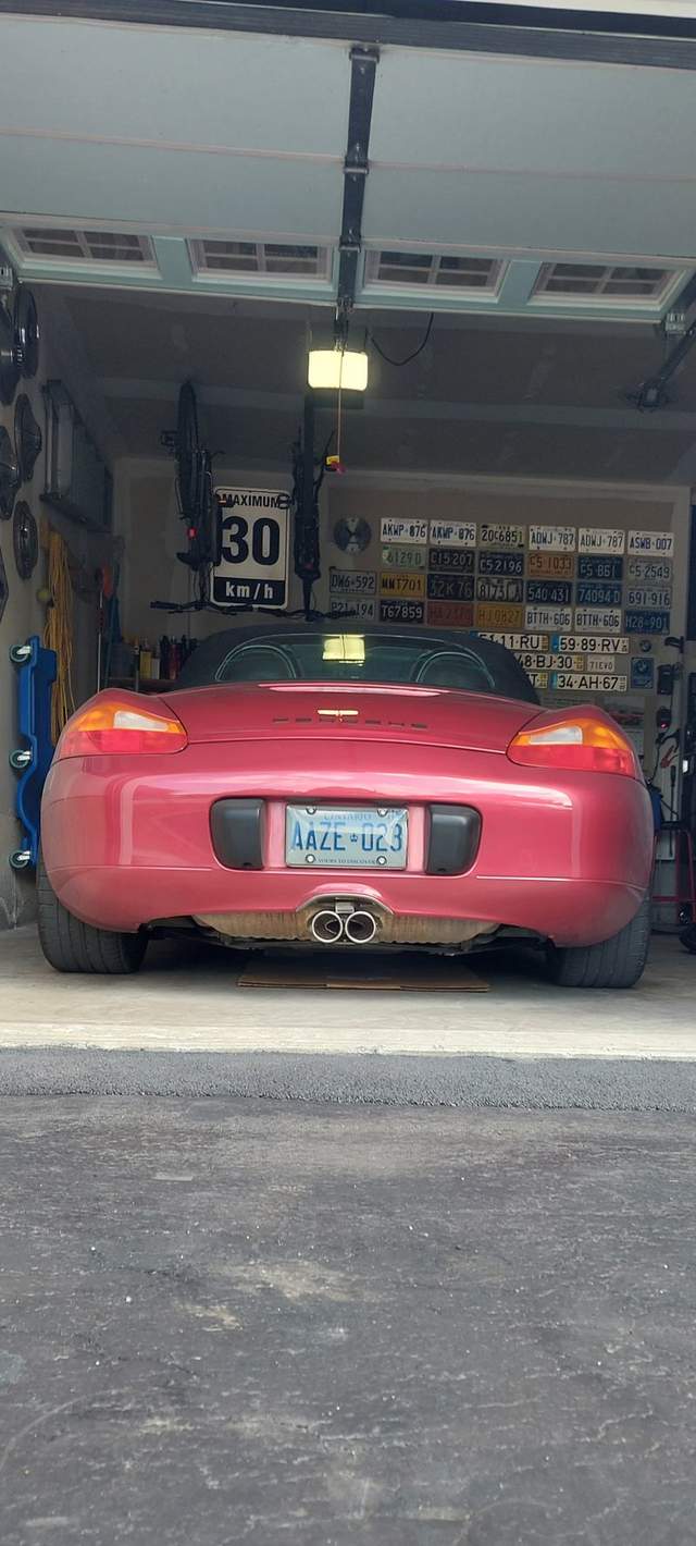

Got my S tips installed today, didn't come out to bad. Basically I grounded the single tip welds with a dremel ( 4 spots, 2 inside and 2 outside) and then took it off and cut the pipe flush with the muffler with a Sawzall, and then just welded the tips on. They actually sit an 1/8 of an higher than the oval tip.

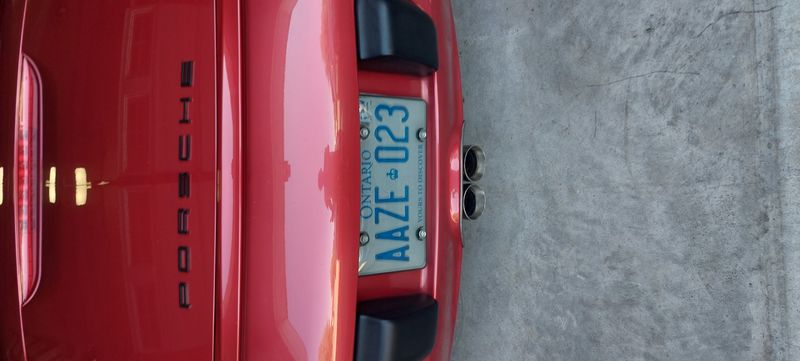

Didn't like how the S tips looked with the top hook and the oval holes showing , so I changed them yesterday to some 3 inch tips that I had with carbon built up inside already and just welded them straight onto the muffler, now you can't even see the holes, it blends nicely with the tips. It looks much nicer to me now than the S tips :dance:
Should've just done this the first time .
