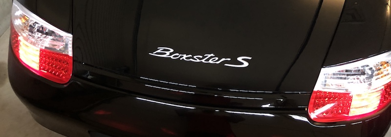

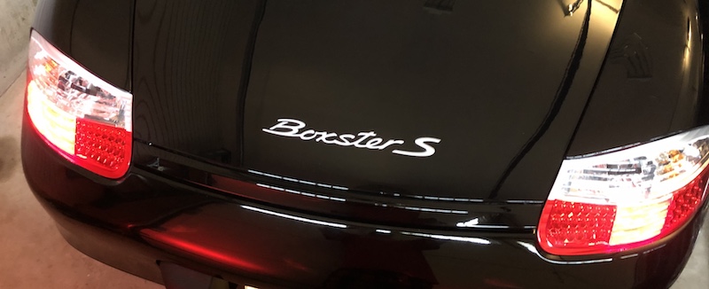

This first pic is with my ignition on and headlights on. The second pic is with all lights on, inlcuding fogs. Theres no one in the car so the brakes are not lit up, and high beams are off if that matters.
